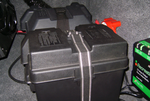

Just simple strap down brackets on the floor with a strap to secure it (the battery box) right in front of the stock battery box. It should be ran so the Isolator allows you to choose battery 1, battery 2, both, or turn them both off.
Oh...and I ran two identical batteries.

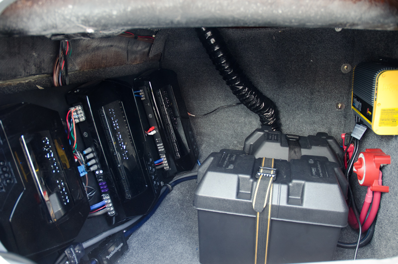

We also went with an Interstate battery (SRM-27). Just used a battery box with a strap. We also added a prosport 12 dual bank battery charger. It's nice to be able to just plug it in at night and know the batteries will stay charged. Here is a pic.

Basically the same setup, different battery charger though.

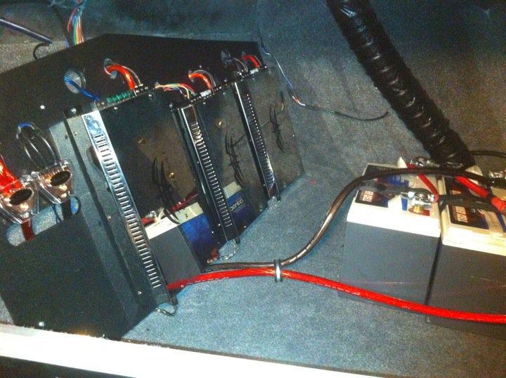

I'm running two D3100's from http://www.4xspower.com. Love 'em.
