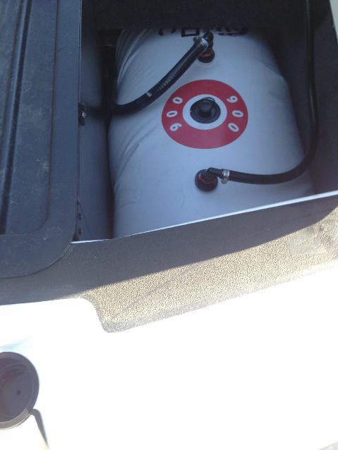

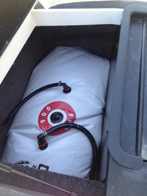

 Post subject: Re: pull hard tanks and go bigger?
PostPosted: Fri Jul 17, 2015 6:34 pm
Here is the bag pretty much full. You can see that I put the fill line on the forward port, and put the stock 3/4" vent line back to the rear port. I did it this way because I have a bunch of lead in my bow and my boat sits bow heavy, the front bag and center hard tank fill very fast and my rear sacks will be last to be full, and the hull starts to come upwards as it gets closer to the transom, so I figured the rear of the sack will be higher than the front of the sack, meaning the air in the sack will most likely be more towards the rear of the sack where I put the vent line.
You can see how much smaller the vent line hose is compared to the fill line. In my second picture I posted above, with all the parts, you will see 2 elbows in the little bags, those are the 1" elbows used for the fill line and drain line. There is one elbow not in the little bag, that is the 3/4" elbow that I needed to thread into these sacks. My fly high 3/4" elbows have 3/4" ports, so they would not work.
You can see in the other picture the sack is pretty much full, it does not even touch the carpeted cover in the locker. I did remove the little L bracket that is screwed into the bottom of the cover so that It will not puncture the sack, but it would not have hit it if I had left it. You can also see it does not put much pressure on the center divider. There is plenty of space on top of the full sack as well. A bit more than I had before.
So far I am very happy with everything. I will know more once I ride the wake, but based on that independent test done on wakeworld last year, my fly high was only 650 in my locker, and the Sumo 900 is 1000 lbs when full. So before I had 650 + 200 = 850. Now I have 1000. 300 more lbs in the rear, it should be noticeable when I ride it. I will report.
Only regret is not going with the tsunami 1200 LONG intake. Also, I am glad I went with my instincts and stayed with the piranhas for my intake. Looking at the tsunami, they would have been impossible to install as the intake pumps, I would have had to use a 3/4" to 1" increaser, then the tsunami "short" pump, but there is no way it would have threaded on, it is taller and wider than the piranhas.
