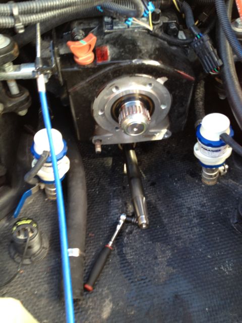

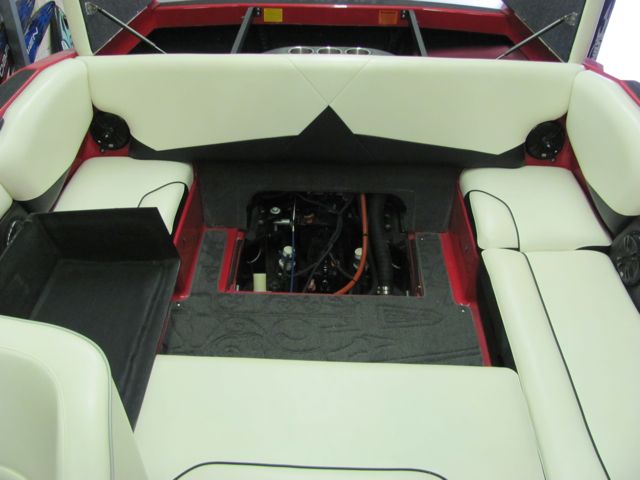

File comment: Start here, 90% of changing the seal will be done in this opening, If you have a prop puller now would be a good time to take it off, the shaft hangs down a little when you uncouple it from the flange, If not put a few towels between the prop and bottom of the boat so you don't scratch anything

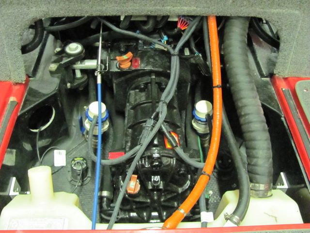

File comment: This is the v-drive unit, there are 7 bolts and 1 nut that you will have to remove, 2 of the bolts are on the bottom and can't be seen, feel for them and you will find them, make sure you remove all of them, when they are out the unit will easily slide away from the transmission, this unit also has 2 large hoses going to it, one from the water intake grate under the boat, the other goes to the sea water pump, I couldn't get the one on the right off the v-drive so I removed it from the impeller housing and took the whole hose off with the unit. There are four nuts and bolts attached to the prop shaft flange, remove these, I don't have a before picture but i'll point them out in the after picture

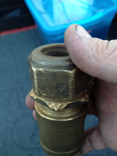

File comment: this is the housing for my original seal, you can see where the dealer got very rough with the jamb nut and used a freaking pair of channel lock pliers and a hammer and chisel on it instead of the proper tool.

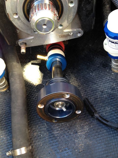

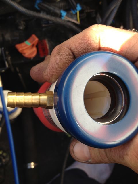

File comment: This is the seal from Malibu, it has a water injection inlet and a double lip seal, far superior to the wax rope that was crammed into the original stuffing box

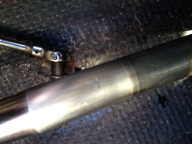

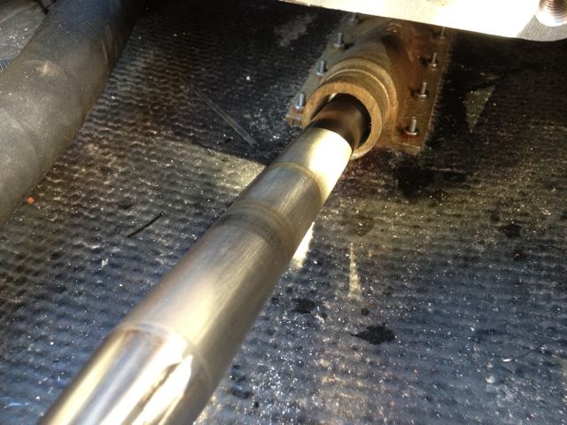

File comment: this is where the dealer scratched my shaft with their freaking pliers, luckily it polished out and didn't cause a problem

File comment: slide the new seal on the shaft, you may add extra grease on the seals if it makes you feel more comfortable but I didn't have any problems, attach it to the housing with the supplied hose clamps

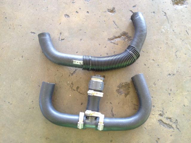

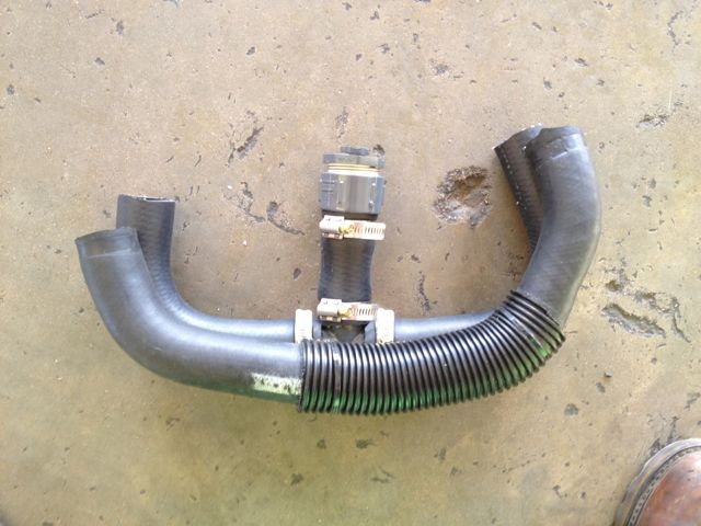

File comment: I went to the plumbing store and made a new hose going from the sea water pump to the transmission cooler to keep cool sea water on the seal at all times

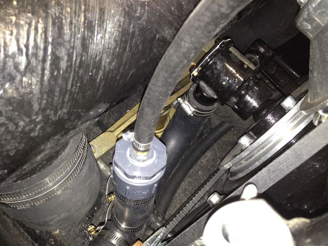

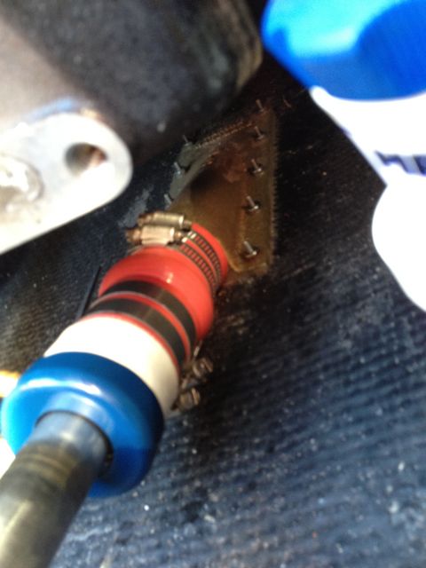

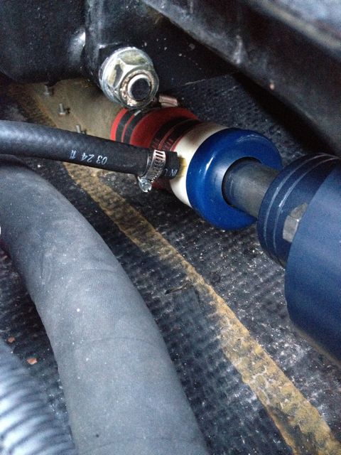

File comment: Here I hooked the new hose back to the impeller housing and the transmission cooler, hooked the other end of the prop seal hose to the fitting I screwed into the hose adapter

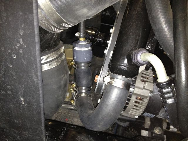

File comment: It actually has a little better clearance than the original hose because I shortened the trans cooler side and it no longer rubs against the right hand stringer, has good clearance in relation to the alternator and doesn't even come close to the steering shaft

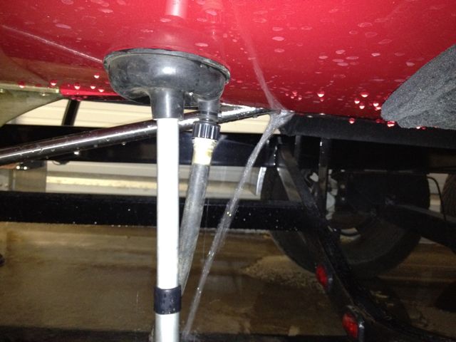

File comment: view at idle, has good water flow to the seal housing

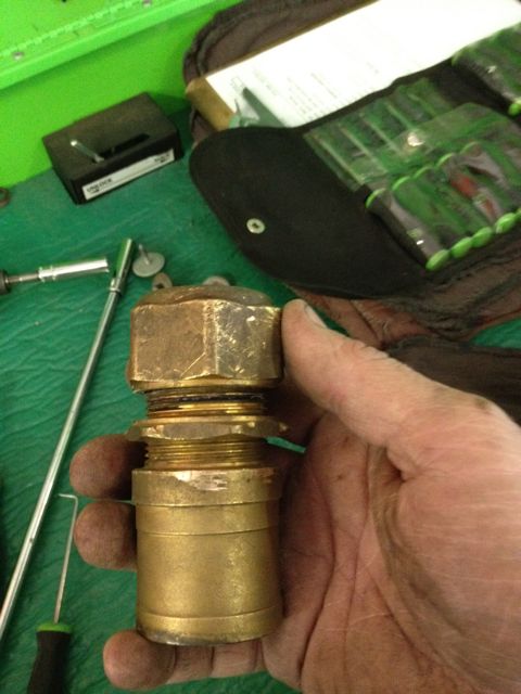

File comment: this is the original seal box, if you want to keep what you have just loosen the thin nut first, holding backup on the lower part of the housing, then snug up the large nut until you have one drop at least every ten seconds, but I will warn you it is a bitch to get access to and it has to be in the water to adjust the gland

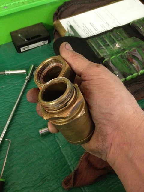

File comment: this is with the seal carrier removed, the seals are loaded in the top of the nut, I wouldn't want to replace these with the flange and v-drive installed, it is very hard to gain access to

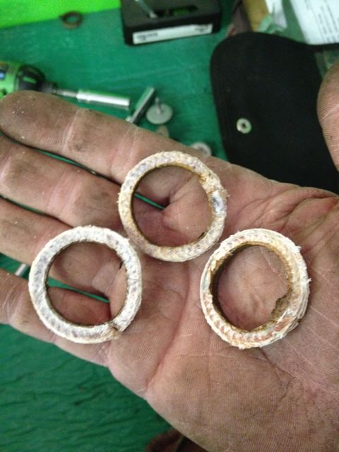

File comment: this is it, just 3 wax ropes slash cut across the side, it is designed a lot like a rear main seal that was used in car engines way back in the day, thats why all the oldies leaked like crazy lol, the dealer had mine so tight it never leaked a drop and got very hot, that may be why the seals turned black, you just can't buy good service any more, do it once and do it right the first time
