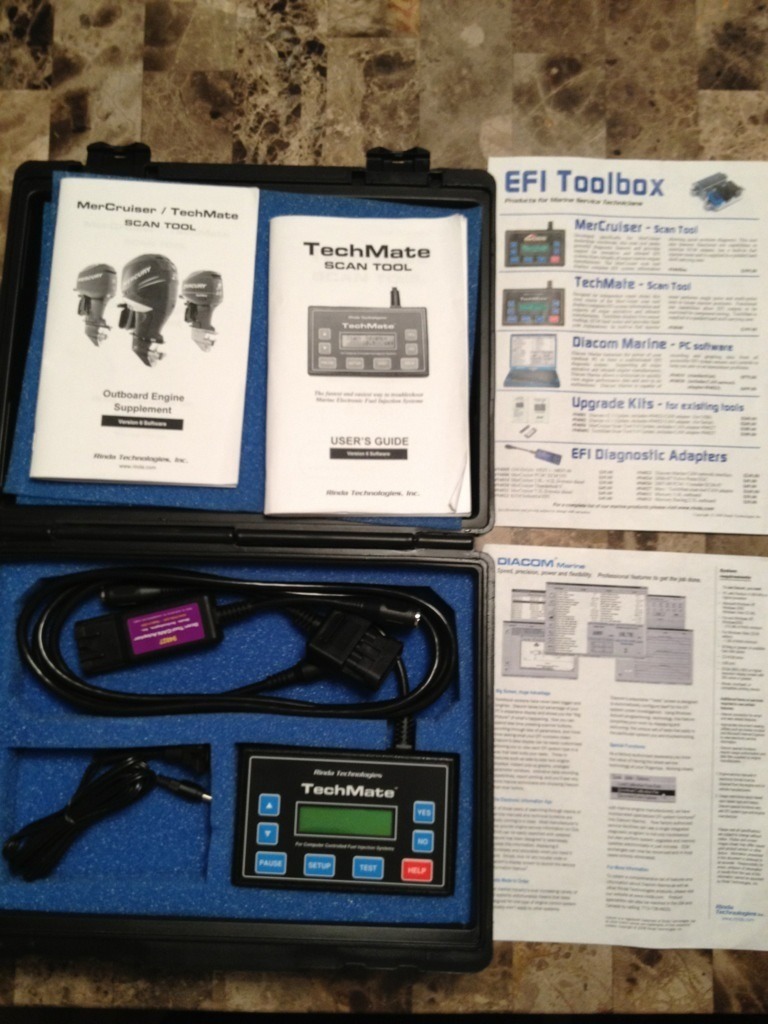

I bought one from Rinda technologies that works on all kinds of boats, 500$

Thanks Walter! Any way to stop the beeping/alert from continuing until the next time I turn the engine on?
2011 A20
 Post subject: Re: Daignostic reader available?
PostPosted: Tue Jul 16, 2013 6:53 am
Not that I know of, did the shift linkage get loose?

just out of curiosity would a generic OBD II scanner work or is it a different interface? since the engine platform is a basic GM platform? or I even have access to a tech II
PostPosted: Fri Jul 19, 2013 11:57 am
The connector is different, I thought the same thing too, the connector is a rectangle shape by the oil drain hose, it's similar to the obd2 plug but marine specific
PostPosted: Fri Jul 19, 2013 12:05 pm
oh well
