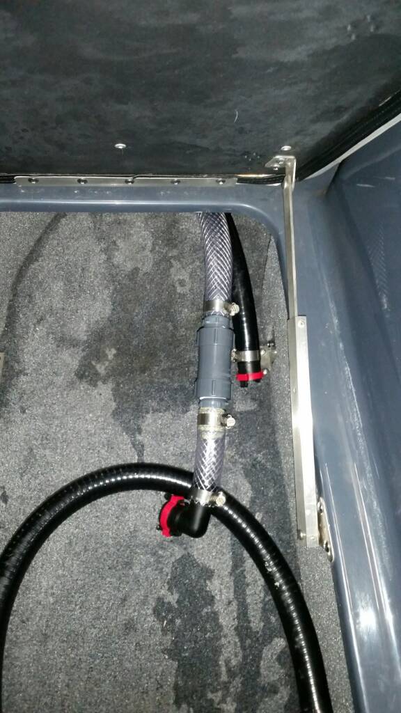

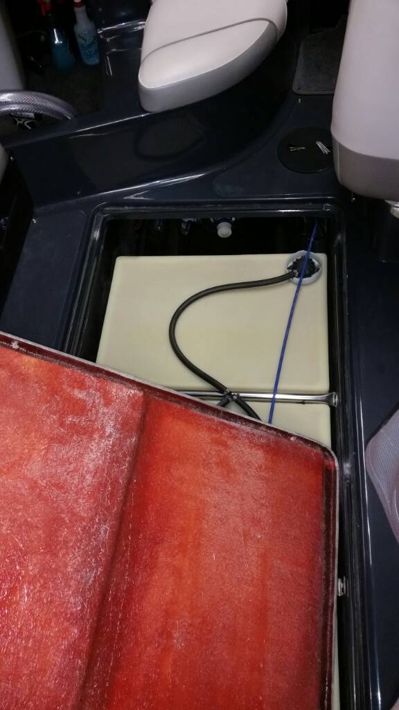

My front bag was draining it's self. Come to find out it was a bad check valve. [attachment=-1]uploadfromtaptalk1398715716292.jpg[/attachment][attachment=-1]uploadfromtaptalk1398715735604.jpg[/attachment]

Check valve on the drain? Mine drains itself too. I was gonna stick a manual cut off on it. Where is the check valve? I don't know what I'm looking at in your pics.

Its that grey thing you see. Yours will be smaller but should have one on the top side close to the cabin. That is the fill line. The one I had before would not hold.

so to clarify its draining threw the fill line?
 Post subject: Re: Front mushroom sac draining it's self
PostPosted: Wed Apr 30, 2014 10:47 am
Yes it was.

My fill line is up high. Mine drains through my drain line. Gonna get ball valve.

I have mine drain into main hard tank so I always fill and then close the ball valve right by driver seat

This in fact did fix my problem. The old check valve on the fill line was garbage.
