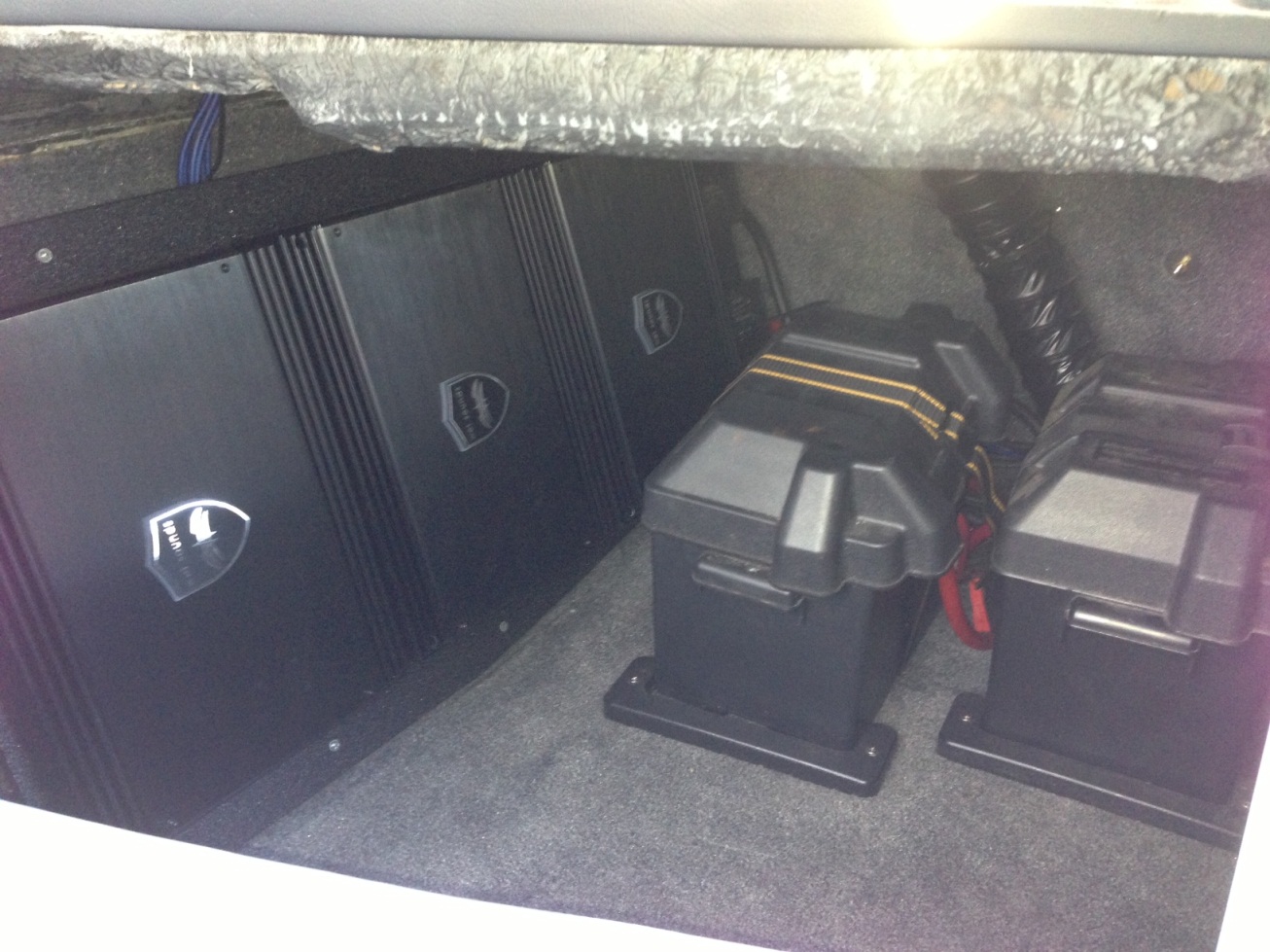

Finally got around to snapping some photos of my completed Stereo Install! I could not be happier. It sounds absolutely insane!!
Inboats - 6.5" JL Audio M650 Coaxials
Tower - Wetsounds Rev 410 and 2 Rev 10
Subwoofer - RE Audio SX12
Amps - Wetsounds SD2, SD4, SD6
Head Unit - Stock Sony
EQ - Wetsounds WS420
XM Radio - Audiovox CNP2000uca Tuner/Antenna
Knukonceptz Wiring/RCAs/Distribution Blocks
Custom Ported Enclosure 1.4 Cubic FT (Net) @ 36 Hz coated in Linex
Custom Trim Panel to Protect Subwoofer coated in Linex
Customer Amp Rack coated in Linex
Also installed a relay for the remote turn on to eliminate the pop noise when shutting off the system.
Enjoy!
Devin

Hey looney I love the trim panel you made to cover the sub. So much so that I am building one like it. If you don't mind what did you use for the screen? I was going to use a fabric but want something more solid. Yours looks like metal and that would hold up much better to my 8 and 10 year olds. Thanks.

Great looking install. How do you have your sub grill cover attached? I don't see any screws. Looks great.
