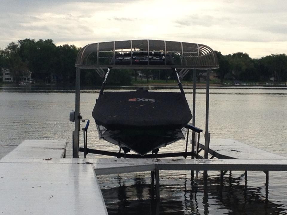

Finally finished! He is some information incase anyone needs it. The bunks are set at 15.5 from the center to the left and right on the front, and 17.5 from the center to the left and right on the rear. The bunks at set up 15" from the lower cross bar on the lift and I set the canopy at 10 feet above water level to the bottom of the canopy. Everything work great!!!
