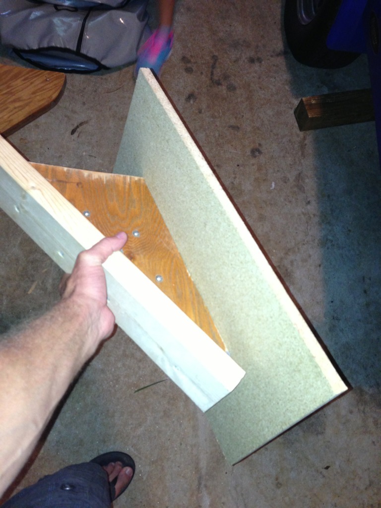

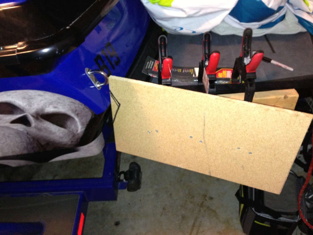

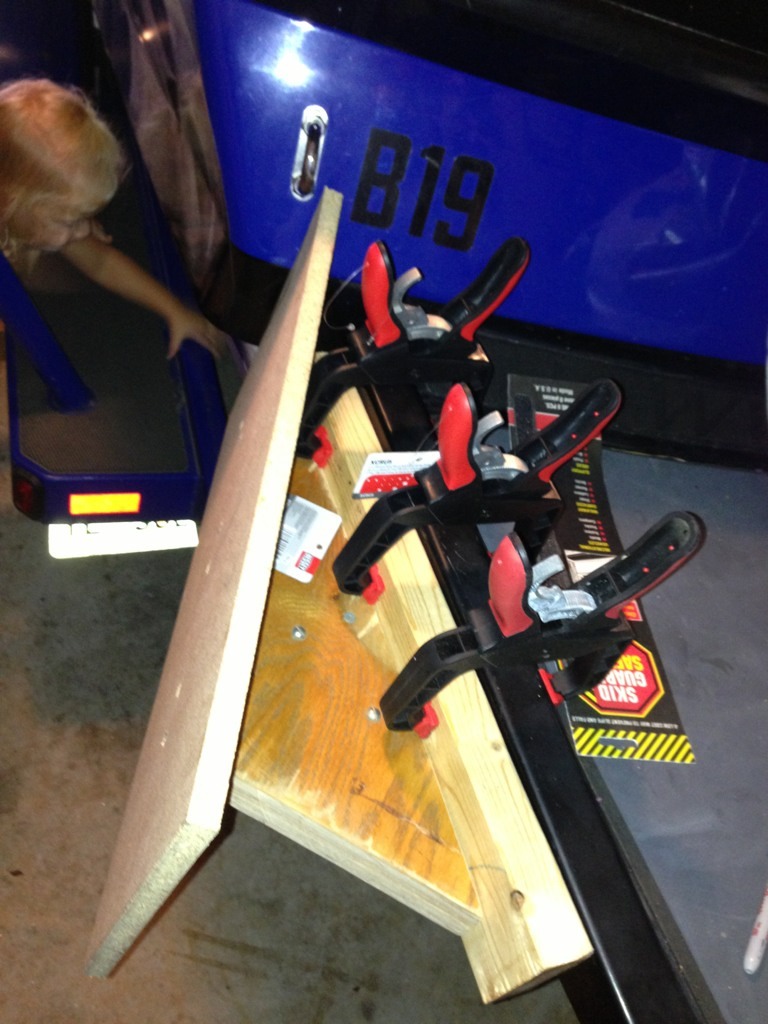

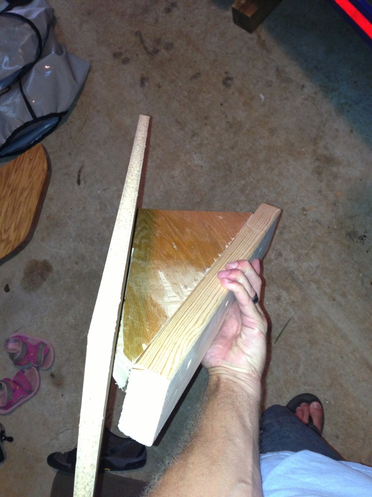

After demoing the '14 A22 w surfgate and crunching numbers I realized I'm still a year or so away from an upgrade. So I wanted to try to make a manual poor-mans wave making device. I tested it out today and was amazed at how well it worked. I didn't put much time into it bc I didn't think it would really work. Here's some progression pics of the build.

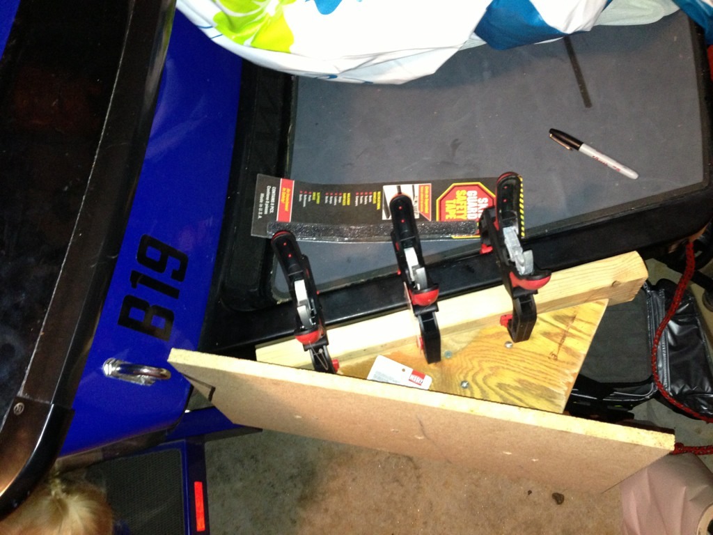

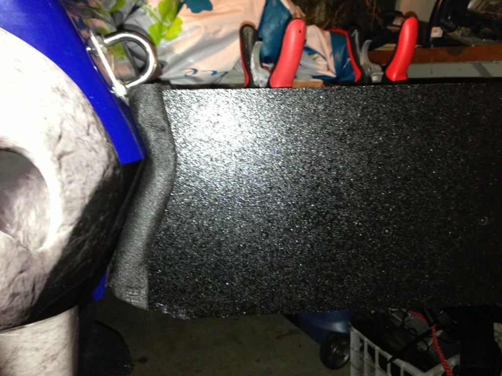

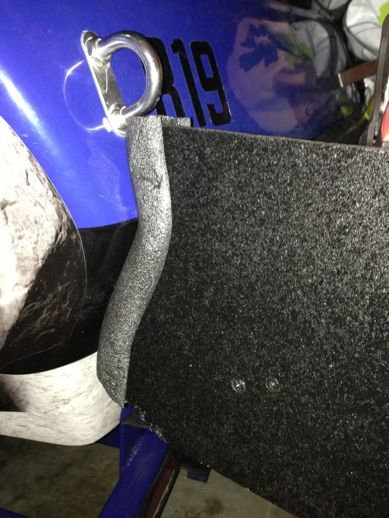

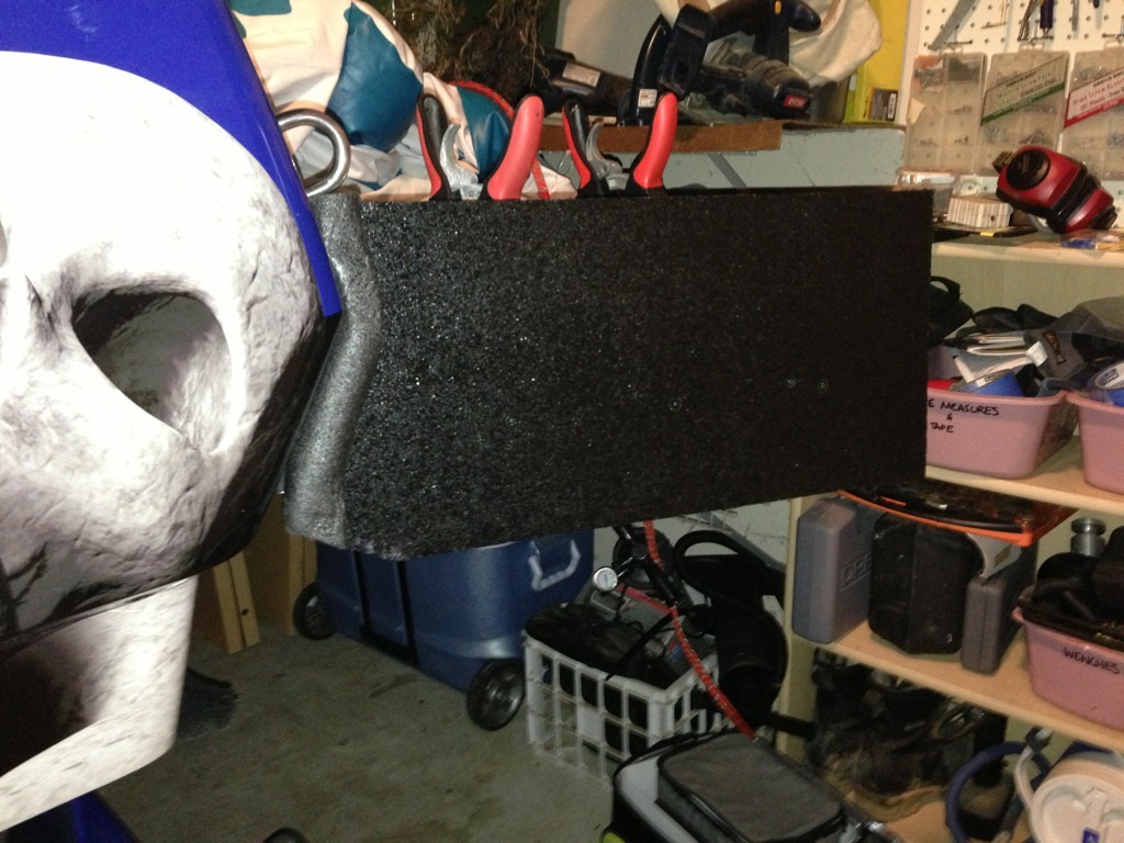

Painted, coated and cut to match the hull. I used a piece of pipe insulation on the front edge to seam it up to the hull and to protect the gel coat.

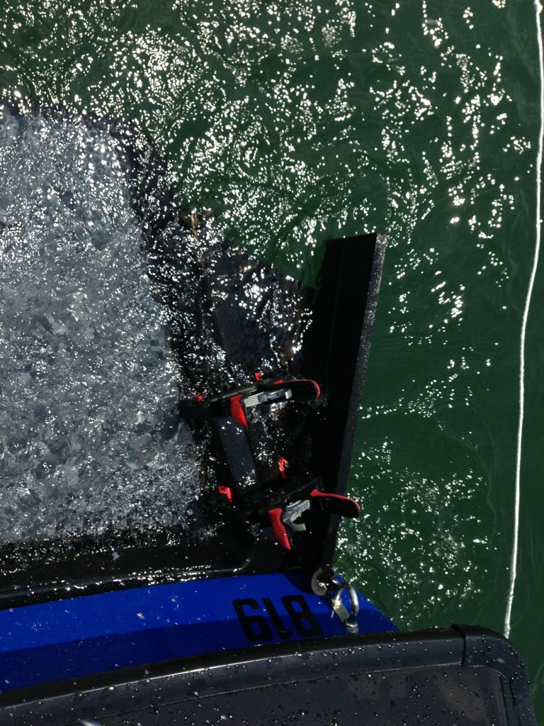

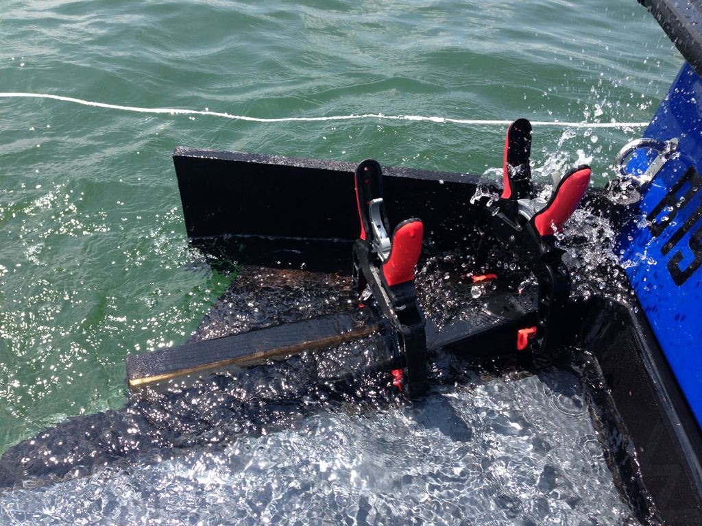

I didn't want to alter the swim deck in case it didn't work. So I just used some clamps to keep it on. I honestly thought the clamps would have a hard time keeping it in place but it worked. I'll post videos in a bit.

For a few dollars in wood that looks pretty good. If you did a version 2 would you change anything? Would you put it any lower? How was the boat weighed?

I only had less than an hour to play around with it today. I may see what happens if I lengthen it about 2 inches and have it sit a lil deeper in the water. Although I didn't try it with the rear 750s full yet. I'll post videos with the weights now. I'm eager to try out another, and see how I could tweak it a bit more. And yeah, it's definitely a cheap prototype. Didn't want to put a lot of time and effort into it in case it was a dud.

This video is with two adults and my 9 y.o. son in the boat and no ballast filled at all. Speed was 10.6 mph (not calibrated). I wanted to start out slowly in case it ripped right off.
