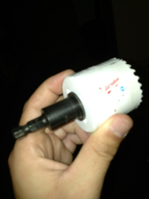

So I guess the small size is your problem? The ones I used to do the paddle wheel on my old boat were fine to run in reverse, but the smallest in the set was 1". They look like this, since the hole is not round, it won't unscrew when you don't want it to:

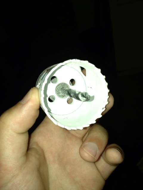

But when it turned out that wasn't deep enough, I went and got this Milwaukee that was all one piece, only the drill bit could be replaced. You could check if they make anything like this in the size you want:

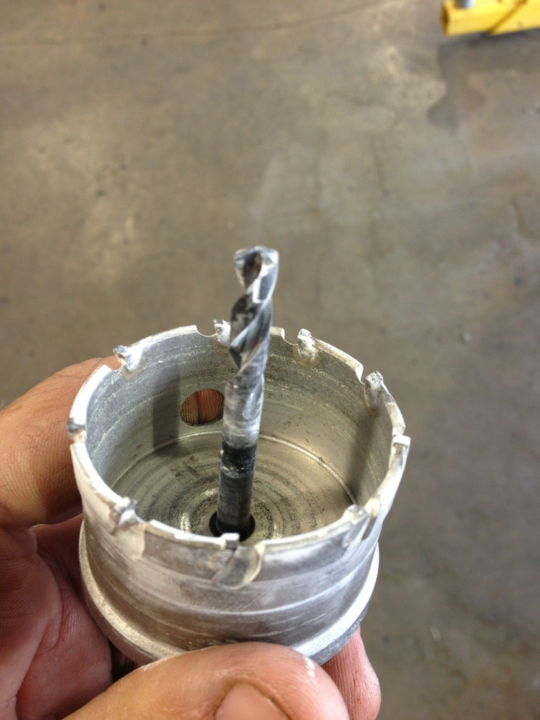

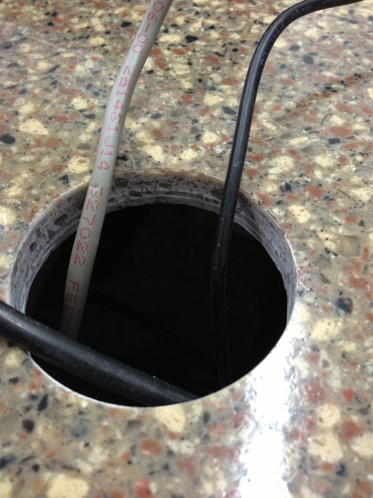

Try to find a hole saw like this, I just cut 3 holes in my new countertop at work and this bit went through it like butter, I'm not sure on the material but its similar to quartz or granite.
The bits are called ROTO Brute
