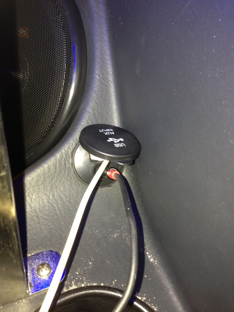

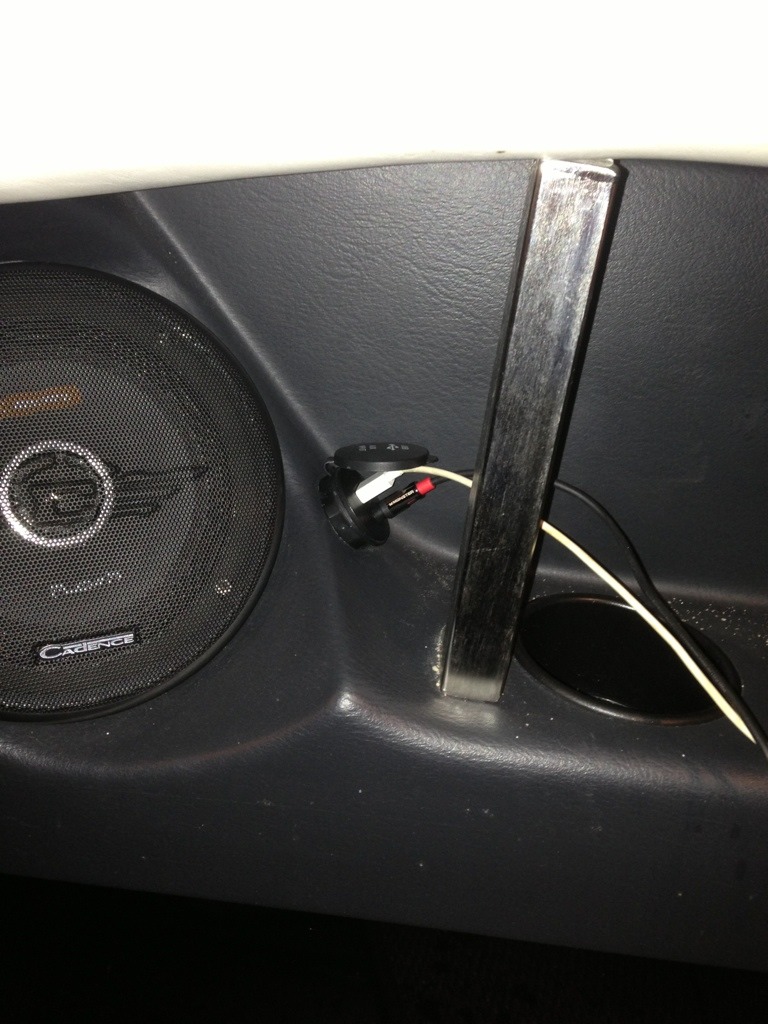

I got this AUX USB port from amazon made by SeaWorthy. Installed in the same place as the 12v plug is on drivers side hardest part was running the cords to the radio.
