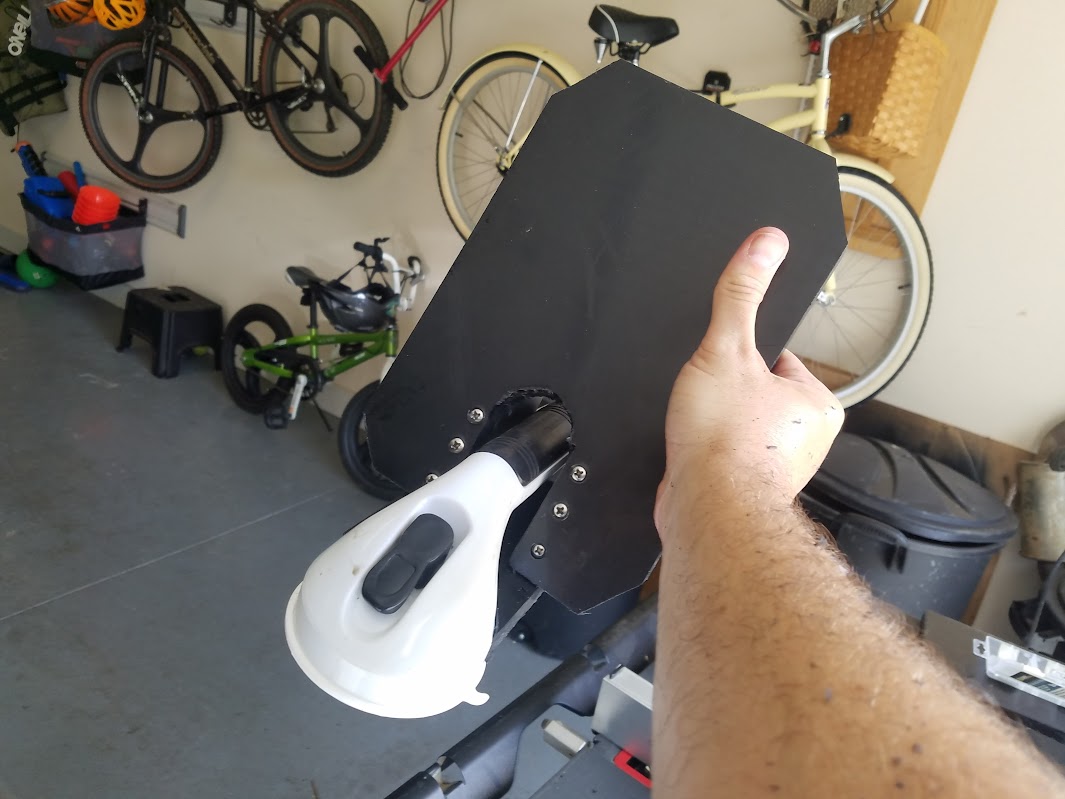

My Suck-gate uses the surfstow handle - floats and stainless springs (no rust issues).
Got the design from "bet-on-black" in the mastercraft forum. Nice and compact:
So much smaller than the fake-gate:
Wave is taller and steeper with suck-gate:
Surf regular side for 1st time ever:

I made a suck gate as well. No cutting or measuring involved.
Bought the heavy duty suction cup handle, a cutting board on Amazon, then I bought two L shaped shelf brackets, and 1/4 inch stainless steel hardware from Home Depot. The angle is adjustable too.
