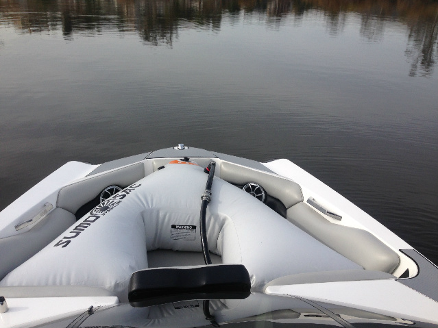

So how do you do this? Did you add extra lines or just add length to the current lines? Do both bags fill/drain at the same time or is it one then the other?
Thanks for the pictures!

I ran an extra long ballast hose from the "front" ballast fill pump that fills the mushroom sack, long enough to reach the new top bow sack (an extra 5' feet or so) The low drain port on the top bow sack drains through a 1" hose (approx 4' long) into the mushroom sack. When I hit "fill" on the front ballast switch, water is pumped into the top of the top bow sack, drains through into the mushroom sack and fills the mushroom, as that sack gets full, the top sack fills. This is how the rear plug n play is set up. So when I hit "drain" on the "front" ballast, water is pumped out of the mushroom sack and gravity drains water out of the top sack into the mushroom sack. I do have to go up there and lift the left side of the U shaped sack to get all the water out, and if I would have gone with a triangle sack I would not have to do this.
When I do not use the top bow sack I hook this long ballast hose back to the mushroom sack, in its original position, and it just has a big loop of extra hose, as seen in the pictures. I can fold up the 750 bow sack and the 4" hose really small and put it in my lockers or under the seats when not in use.

Gotcha, pretty much what I was thinking about by extending the hoses. Great work! One thing I'm confused on...if you have a vent on the lower bag how does it not let all the water out there before filling the upper bag?

I believe the reason that the top sack is able to fill all the way with the vent on the bottom sack is the height of the vent through port in relation to the height of the water in the top bag. when sitting the vent through hole is higher than the top sack. Where I am running into trouble is when getting up on plane AND when on plane the vent through hole drops below the water level in the top sack, so it begins to drain water out of the vent line, but just a little dribble. My main issue is that the water pressure is forcing water past the drain pump and up and out the drain thru hole. A ball valve like pilot flying mentioned is the fix for that.

Here is another picture of the bow bag completely full. I had a hard tome keeping it full on my test run because the pressure of the water of the top bag would push water out the vent and drain lines of the bottom bag, so it was constantly draining when boat was at speed. I added a $5 pac ball valve to the 1" line between the top and bottom bag. Once the bottom bag is full, I then close the valve and top off the top bag. I leave this valve closed until it is time to drain. It worked perfectly, now the bow sack is completely full and they do not drain on their own.
