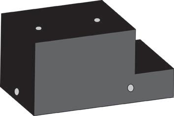

There is the W719-EXV 1100lbs bag that has the extra drain port and is what I will probably get, But it had me thinking about getting a custom bag that also had a small tail the went under the small square corner seat and fit the locker perfectly (drop in cooler would need to be removed).
Are custom Fat Sacs super expensive?
Anyone else interested in a custom rear A22 sac so we could get a bulk discount?
Thoughts in general on my idea/plan?
Here is what I was thinking for a custom sac design:
File comment: Green shaded area represents are fat sac would occupy
File comment: Idea for a custom fat sac

There is an option for it. I cannot remember exactly how much more it costs. How much extra weight do you think you will get out of the extension? We have done custom bags in the past with a long tail for the older Malibu boats but that tail was as long as a 400lb tube sac. So you got some bang for your buck on the bigger Malibu bags we did in the past. If it will only gain you a few extra lbs might not be worth the extra money.
Might be cheaper to just get a bag the size of the X2 rear bag and add an extra port on it or see if you can just make the bag a little taller. Not sure the exact size of the bag walter bought I think they were the X2 bag.

I did not expect to get much weight from the tail but I thought it may help keep the bag in place and off the engine divider and it would be a nice to use all of the space that efficiently. I am looking at the 1100 bags with extra port and plan on reenforcing the engine divider but thinking out the project just got me thinking how much more a custom one would cost (slow days at work cost me a lot of money due to daydreaming about boat projects). It would have to be under $300 for me to even consider it since the 1100's w/ extra port are around $200.
I am going to head out to the boat right now and measure it up to see exactly what shape it would be.

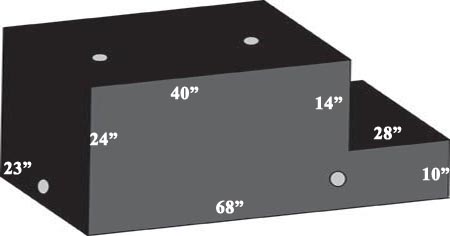

I measured it up and did a little math (hopefully my math is correct):
The Fly high 1100 lb bag actually holds 1034 lbs. completely full which it probably would not be in the A22 because is a little too long
A custom bag would hold 1020 lbs. and hopefully fill completely. Not sure if its worth the extra money but am a little curious how much more it would be.

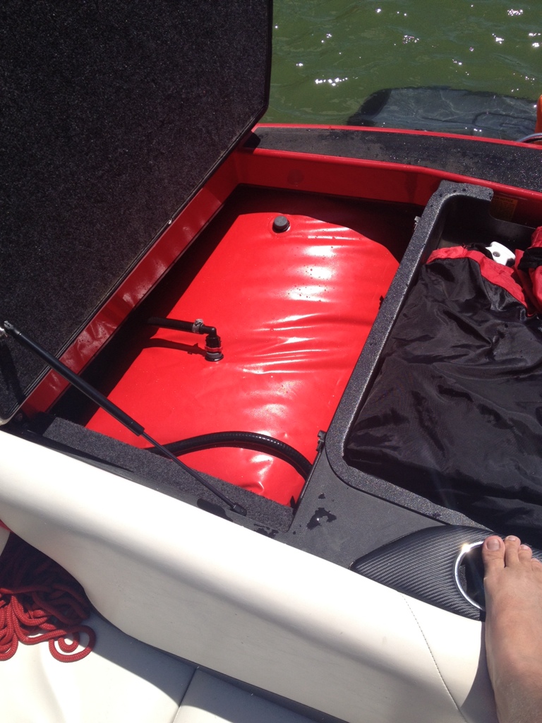

The 720lb x-star bag I ordered fills completely and takes up the entire compartment other than the little front under seat area, a 150lb brick would probably be the equivalent of that. I'd say if you utilized all available space you may get 850-875 back there. Here's my 720's full
