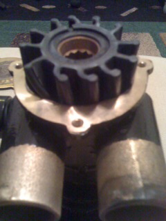

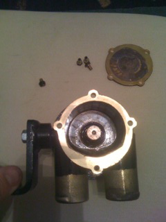

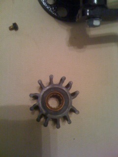

Don't be the guy on the bank working on his boat all day because he never replaced the impeller, I have been there with plenty of my friends and their boats. I just removed the impeller on my vandall and it's already starting to take the shape of the housing. Indmar recommends checking the impeller annually and say it's good practice to replace it at that time anyway, engine owners manual section 6-14. It's recommended to replace every 2 years but after seeing with my own eyes how tight the housing squeezes it, i'll be changing mine annually. I would suggest you guys do the same to save yourself a headache. It's really easy to do yourself, took me about 5 minutes to remove. All I need to order is the impeller and a gasket. You will need a flathead screwdriver, A 3/8 allen wrench and two 1/2 inch wrenches. It's much easier to just remove the whole housing to get it out rather than try to pull it out still installed on the crankshaft. Then just pull it out with some needle nose pliers. Just a reminder to everyone to check the most forgotten part of your boat, just because it's new doesn't mean it won't leave you swimming!!
