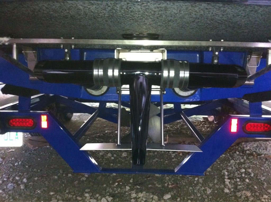

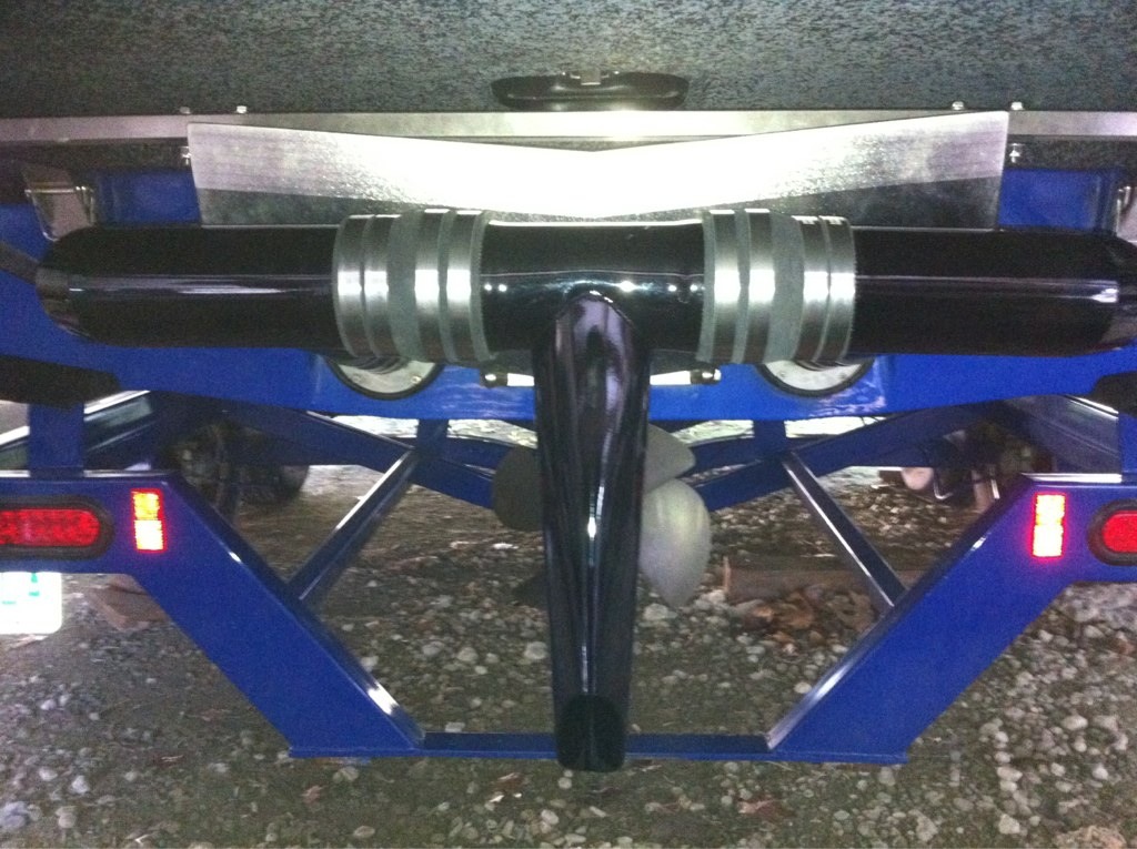

I've got one on mine. Had one on my family's moomba as well. They are awesome. No carbon monoxide fumes while surfing and considerably quiets the engine noise.

None at all. Wish I'd taken some before and after pics to show that but there are some on the fresh air exhaust web site. It truly is an upgrade that's well worth the cost.

Agreed. The axis definitely has noticeably less CO fumes than some other boats I've surfed behind. My family's moomba was almost nauseating. I wasn't going to put the FAE on my axis at first until a few of us got bad headaches after consecutive long days of only surfing. After installing it, no more headaches. My 6 and 8 year olds both surf so it was a no brainer for me. Anyway I could lower their exposure was worth it. All boats definitely create a pocket of CO behind the boat at lower speeds (station wagon effect) but keeping the center window open is a great idea.
