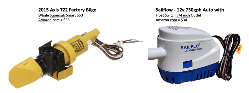

Hi. I have a 2015 Axis T22 and my factory center bilge pump has been intermittent when running in the automatic float mode. When running in the manual mode with the toggle switch it runs perfectly. I wasn't sure if I should replace the original factory bilge, Whale Supersub Smart 650, with a direct replacement? Or should I look for a different unit of comparable size? Customer reviews on Amazon for the Smart 650 aren't so great. There seem to be other similar pumps that have better reviews. I'm not too concerned whether I spend $30 or $60, I just want to do the remove and reinstall one time and have a reliable pump.
Wasn't sure what kind of experiences you guys were having?

I replaced my with the whale super sub. I am not sure I would do it again as there is always 1/2 inch of water that it does not pick up. The other pump might get it
