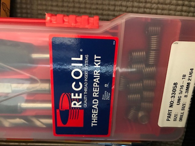

I had the exact same problem. Just get a thread repair kit and follow the instructions. I used a recoil thread repair kit and it worked like a champ.
That's the plan! Thanks
