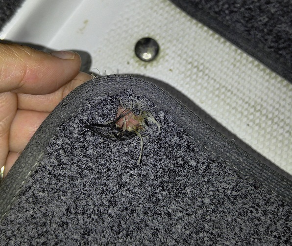

Any idea where I could get my carpet repaired? Guess all the times of pulling the carpet up took a toll on it. The snap ripped out of the carpet and stayed attached the boat, basically i have a whole in my carpet now where the snap should be.

See if your area has a goto person for cover repair. The canvas person should be able to repair the carpet for you.

You can buy a grommet repair kit at HD or Ace Hardware and do it yourself very easily.
P.S. put a light coat of marine grease on the parts before you snap them in the boat, it
will prevent them from sticking.

Any suggestions on patching/reinforcing the whole it made? I want to keep the snap in the same part of the carpet.
