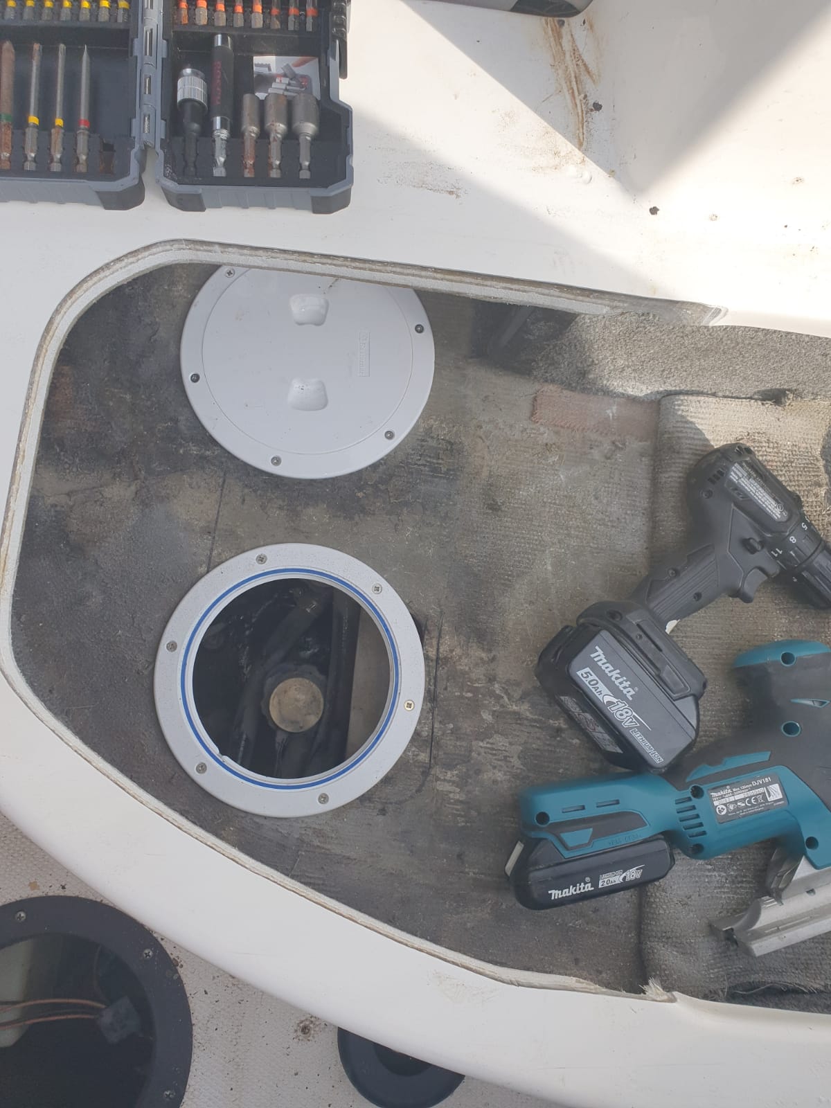

I have always just pulled the rear drain in my steep driveway each night. I get the water out. I did finally cut an access port under the walk through area to access the bilge, and replace the pumps. Axis was not helpful at all in the matter.

I'm about to do that myself - I don't see how it's possible to work on the pumps through that circular hatch.

I wanted to upgrade the pumps to 1100gph - there was no way I could see being able to do this through the black circular hatch by the drivers seat so I cut away a section of the walkthrough and added 2 more hatches into the floor. I will drill another circular hole which will be the fill / drain line for the bow arrow sac and allow water to drain into the center bilge..
