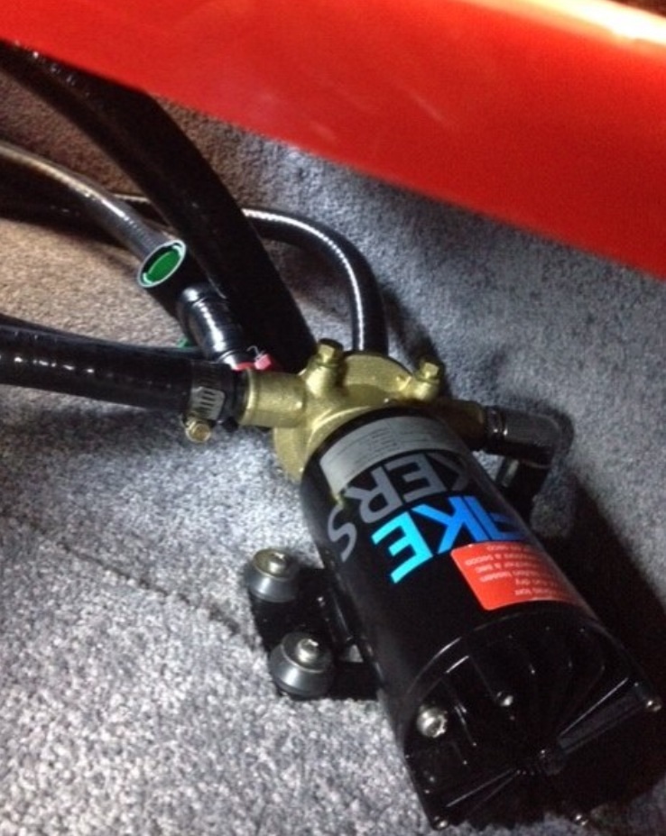

Hi there , have installed a wake makers reversable ballast pump to fill & drain additional bow bag when surfing. Fill & drain out the same threw hull fitting that is the front drain T Handel plug hole , never used that drain plug . Works very well , sucks the bag right down flat . Sorry it's an A22 , but an easy install on any boat.

Thanks Peter! Where is your pump mounted in that pic?

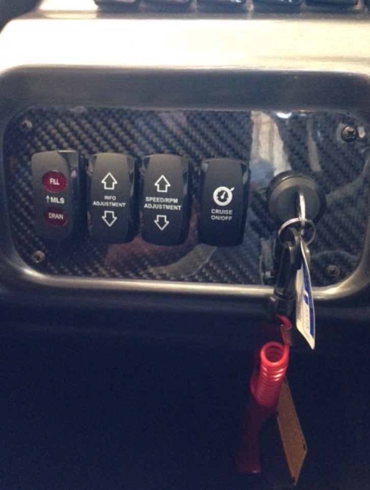

The pump is mounted under observers seat , just pull bag out from under seat 400 pounder fill & drain as needed . Set up switch on key panel .
