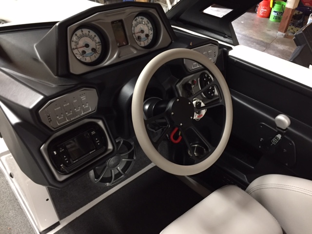

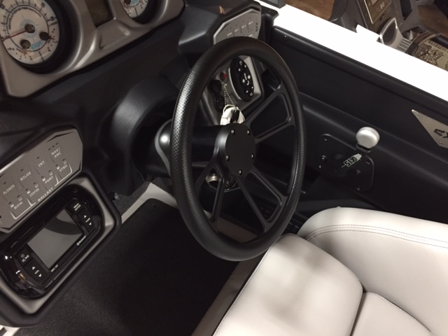

So thanks to is post, I was able to upgrade my steering wheel in my '17 T22. The biggest challenge was getting the old one off...had to pretty much destroy it because the puller wouldn't grab onto it. Needed to cut holes in it for the jaws to grab securly. Went with a Forever Sharp half-wrap wheel (14" Muscle) and the 19 spline marine adapter. With the half-wrap, you can easily change colors etc. if you want. I got two. One "carbon fiber" and the other gray.
I would highly recommend using a puller to remove the old wheel to avoid putting too much pressure on the steering mechanism.
Thanks for the original leg work on the right combination of components.
