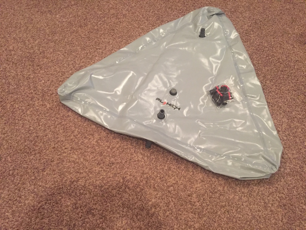

I got the sac. It is the High Fly bow sac. Install tomorrow!

Looks good! Those plug locations look weird but maybe the bow on the T23 is different than the T22. Good call on the elbows. I didn't know to order enough inititally so had to wait another week for the connectors after getting the back, it sucked!

I have two 90's and two straight. I was told use the 90's on top for fill/vent and a straight for the drain. Almost think I should have 3 90's

That is the same fly high sack I have in my T22 and you will definitely want a 90 on the drain. You could probably get away with a straight connector on the vent if your hose is long enough.

Got it done. I put 90's on the Drain/Fill. Had to shorten the drain hose about 10" but it all looks good. The dealership said the bag would hold 750lbs it looks like it should fill up almost all the way but I can't find a exact weight for it anywhere. Is it 750 or 650?
