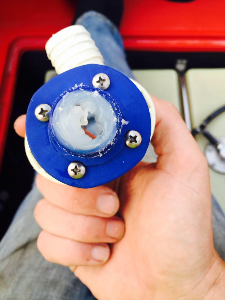

Finally pulled the drain pump and found this!!

I just pulled the 6 screws from the floor and the pump is right there easy to access. It was all silicone from the factory. 15 min at the most

Bagdragger, take those 4 screws out and then look at the impeller. Do NOT clean out the silicone. That is there on purpose to seal the electrical connections inside the pump. You're not looking at the pump, your on top of it.
