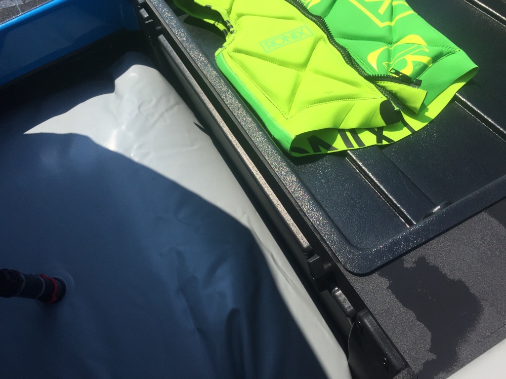

Mine is reinforced but has some flex still.
