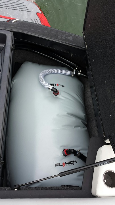

Using that rear ballast fitting, wouldnt it be pretty easy for the bag to start draining while surfing? Just curious, like this picture.
