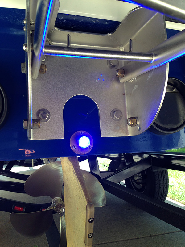

and for good measure, I threw this led drain plug in as well...35 bucks on ebay.

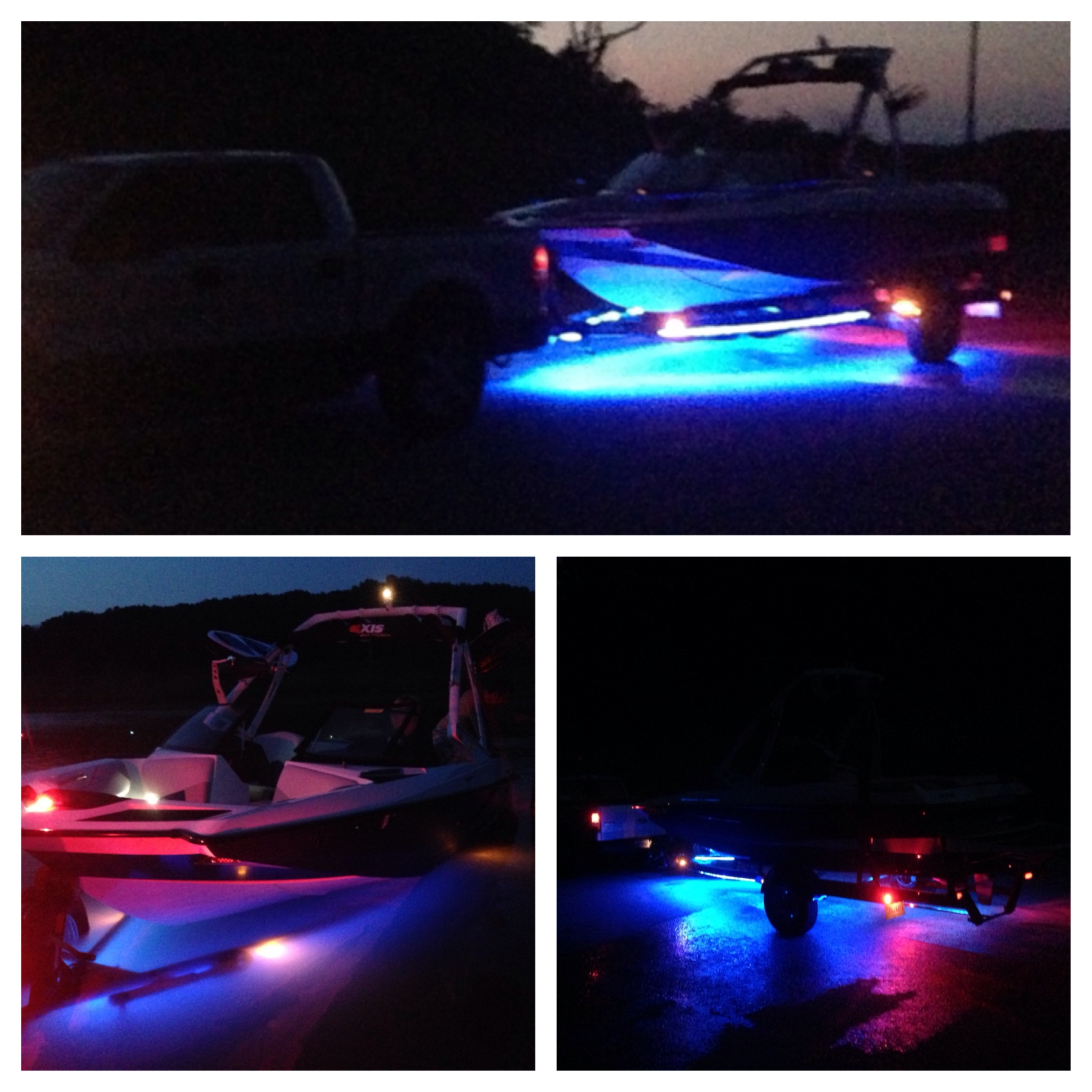

some photos from after dark tonight at the lake...they worked great, bottom left is on the ramp, trailer in the water, the other two are in the parking lot.
