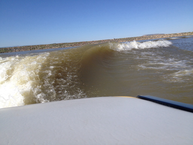

Www.wickedwakesurf.com
I ordered one a couple weeks ago and now I don't have to get a new boat with surf gate. Makes all the difference in the world, even with the 2011 platform. Joe is great to work with!
