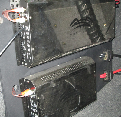

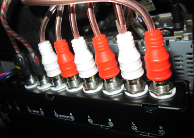

OK.... Next time I decide to get under the front I will have to do one of 3 things. Either remove the seat, lose 20 lbs, or learn Yoga. With that being said, I hope these help.
I am running the SP3. Keep in mind that mine was not hooked up correctly from factory and my dealer fixed it all for me. I am also running my power through an Aux switch so the radio doesn't turn off when I stop the boat and have to turn the key back.
First pic shows SP3 amps with RCA cables.

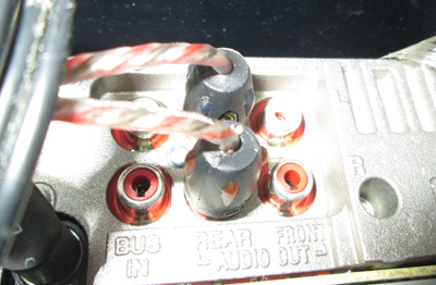

Second pic is of the WS420SQ and the RCA's from the amps plugging into the EQ. Also have one more set of RCA going to back of radio. Pics 2 and 3.

File comment: SP3 amps and RCA's
File comment: RCA's from amps plugging into EQ
File comment: RCA from EQ to radio

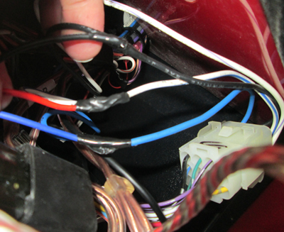

This is the power wiring.
From EQ you will have a Red, Blue, and Black.
From my radio I have a group of wires running into a white plastic connector as seen in pic.
The Black from EQ is spliced into the Black from Clip.
The Red from EQ is spliced into the White with a Blue Stripe from Clip.
The Blue from EQ is spliced into the Blue from Clip.
Hope this helps.
File comment: Wiring from EQ to Radio Power
