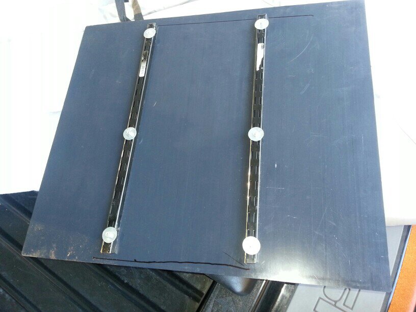

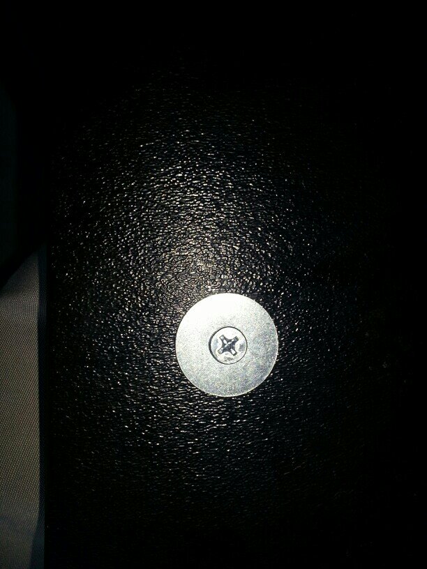

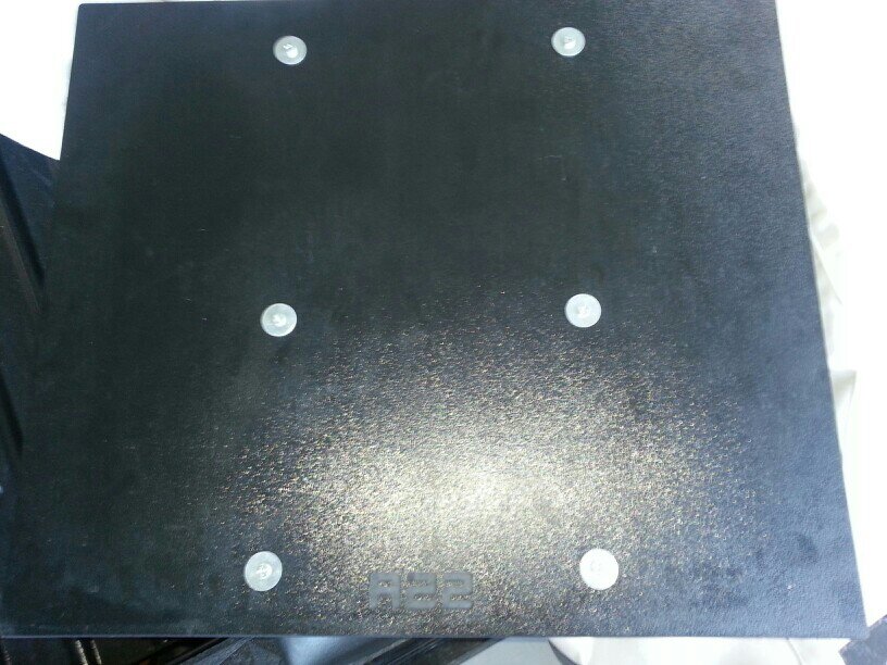

PostPosted: Tue Mar 25, 2014 5:00 pm
[attachment=-1]uploadfromtaptalk1395788415104.jpg[/attachment][attachment=-1]uploadfromtaptalk1395788430491.jpg[/attachment][attachment=-1]uploadfromtaptalk1395788446250.jpg[/attachment]
 Post subject: Re: Ballast question
PostPosted: Tue Mar 25, 2014 5:02 pm
All for about $30 at your local hardware store.

PostPosted: Tue Mar 25, 2014 5:05 pm
Honestly you could probably get by with one rail going at a 45* angle with 3 bolts and washers and save a lot of time and it would offer ridgity to the engine divider.
PostPosted: Tue Mar 25, 2014 6:37 pm
Posts: 75
Oh sweet. So it's just bars bolted onto the walls. Thanks dezul for this. Might have to pick up 1100's instead of 750's now.
