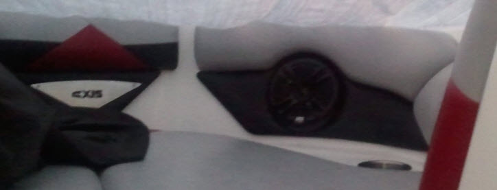

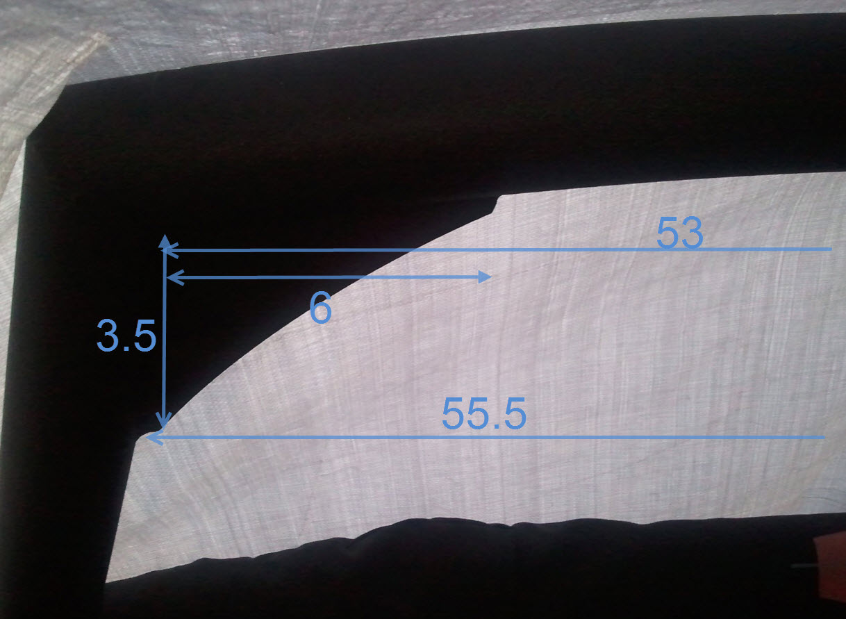

These dimensions are from an 09 and I'm not sure if the bow has changed enough to allow for larger speakers. In my case the speakers are 7".
The tower has 53" of space inside, but less for mounting due to the corner supports. When you drop below the corner tabs it increases to 55.5". The 3.5" dimension is measured vertically. The corner supports are 6".

Thanks a lot for the pics. I was hoping 2 pairs rev 10s and a 410 in the middle would fit but it won't :(

I wanted to add another pair of rev10's, but you would have to add them to the sides- or up on top of the tower. the 410 with 1 pair of rev10's sound awesome though. Make sure you give them enough juice!
On the 808's you probably can get them to work, but you would need to cut the cushion panels and then reattach the vinyl. Have you considered keeping the 6 1/2 and adding the 808's on the floorboard panel?
