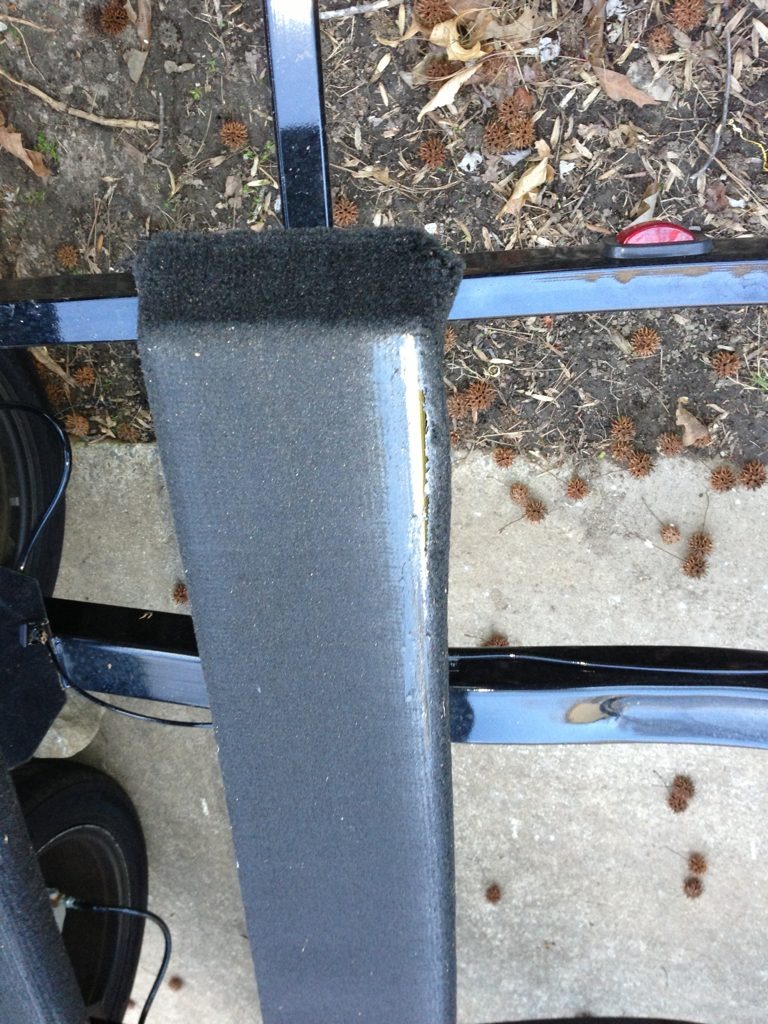

I have a 2012 boat mate trailer and when I broke boat out and was waxing it I noticed Scratches on bottom of boat inline with the bunkers so when I put boat in water on Saturday I found the Culprit
Has anyone else had this problem with there bunker carpet. I talked dealer and its not covered under one year Warranty

I had this same issue and it too caused severe scratching on the bottom of my boat (both sides).
Turns out not only was the carpet covering the bunkers inferior quality, but also the bunkers were not properly alligned and the bolts were stripped and the bunkers couldn't be properly re-alligned.
Ultimately, Axis agreed to pay the dealer to buff out the bottom of my boat, this was all being done at the same time they had to redo some of the gell coat due to small bubbling in several places.
At that same time they also took the trailer back to Boat Mate Trailers, where it was redone. The bunkers now have a better quality carpet covering them and they seem to line up better when loading the boat. Seems they used a better bolt system to hold the bunkers in place too.
They had the boat almost all winter (two years ago) to complete the repairs. I was insistent that it was not due to operator error and pushed them to fix it. Axis took care of it all for for me, dealer helped me convince them it was a design issue with the trailer.

When they redid mine they used a much heavier grade carpet than what was originally used. The original carpet cover was just like the stuff shown in the picture above, the stuff now is at least twice as thick and plusher.
