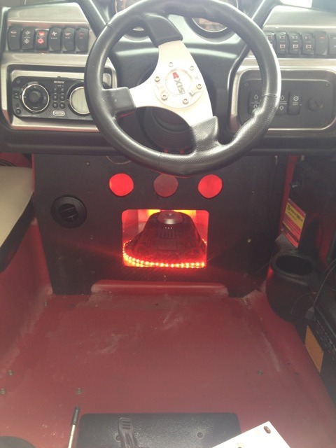

 Post subject: Re: Group Buy Heatercraft Heater / Shower
PostPosted: Fri Oct 18, 2013 2:01 pm
