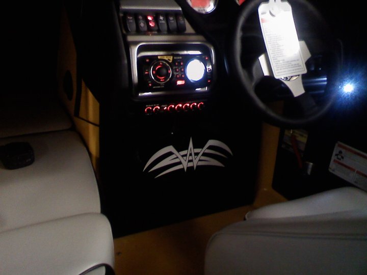

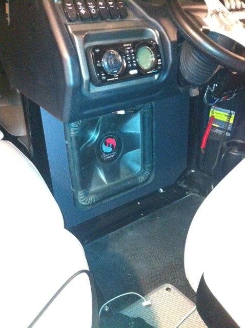

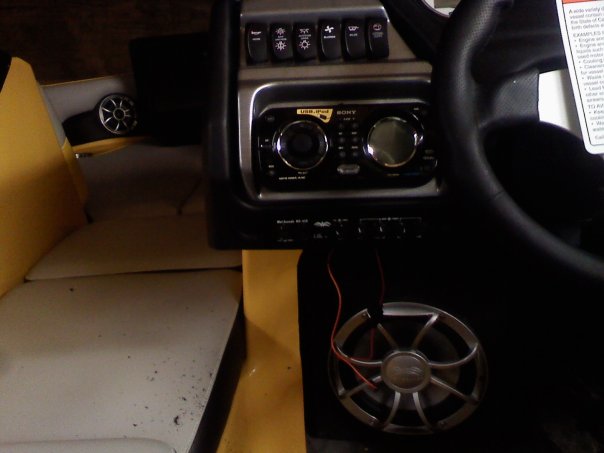

I put a WS-XS10 in a box powered by a syn micro. We pulled out the foot tub and put a plexi panel painted black in its place using the original screw holes. The Wetsounds logo is raised and acts a vent for the sub. It hits pretty good. No big rattling issues after 2 years. The heater tube rattles a little and the tower mirror shakes a little, nothin terrible.

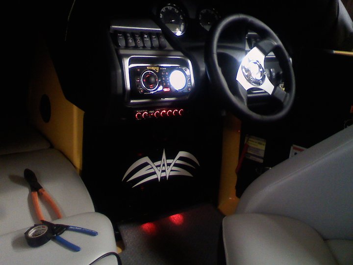

Finally got my sub in-
First had to do some trimming
I had some clearance issues. I think it's just my boat as Walter and others have had NO problem.
I trimmed some of the top to clear the steering column and bar
Installed! Now I have to trace down some rattles...
