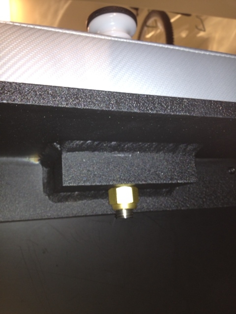

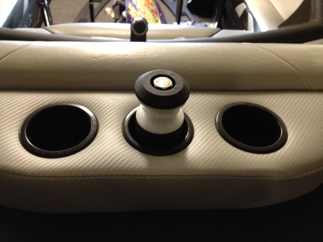

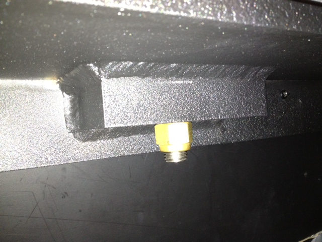

I know that I expected more when I got mine too but it has worked really well on the 2011 A22. It went in right where the center cup holder is and bolted right into place. Took about 5 minutes to install. If you want pictures, I can post some tomorrow.
Zak

Walter wrote:
Yes please, pics would be helpful, also has anyone noticed any stress cracks in the gelcoat where the brackets bolt to the boat on the inside?
Looks like mine was much easier to install than some. I haven't noticed any stress cracks in the gel yet. Hopefully they don't show up...
