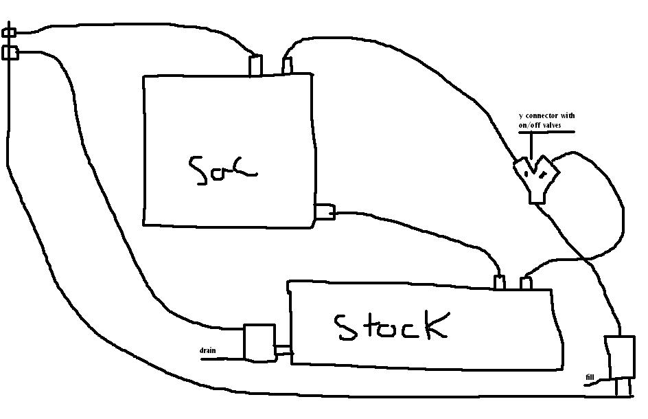

I installed my rear pnp with a Y selector valve. this way when i want to fill my the pnp sac I can open the valve and fill both hard tank and pnp at the same time. still drains the same way but i think it fills a little faster
