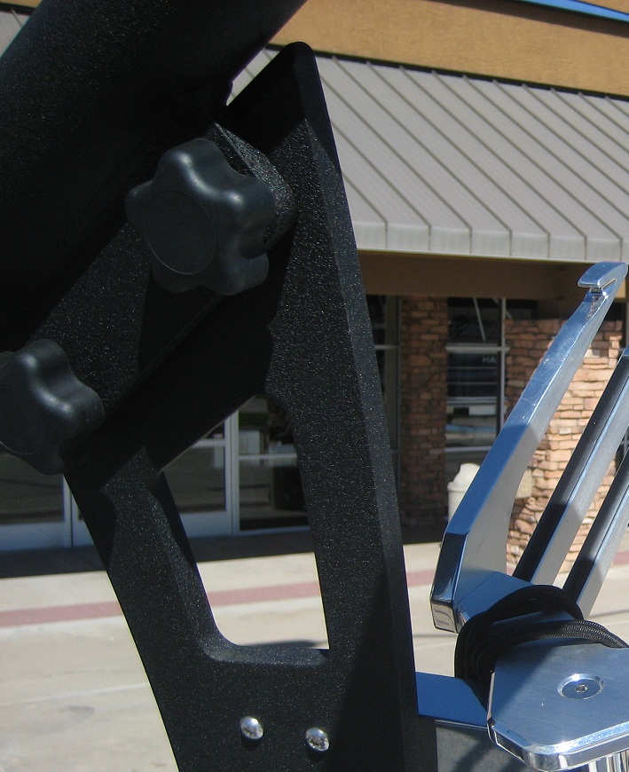

Thats where im having the problem. The tower bracket is on the outside of the bracket that it attaches to the tower. If I take the 2 screws out, the bracket wont lower unless the tower is raised a couple inches so it can clear the tower bracket.
File comment: bracket
