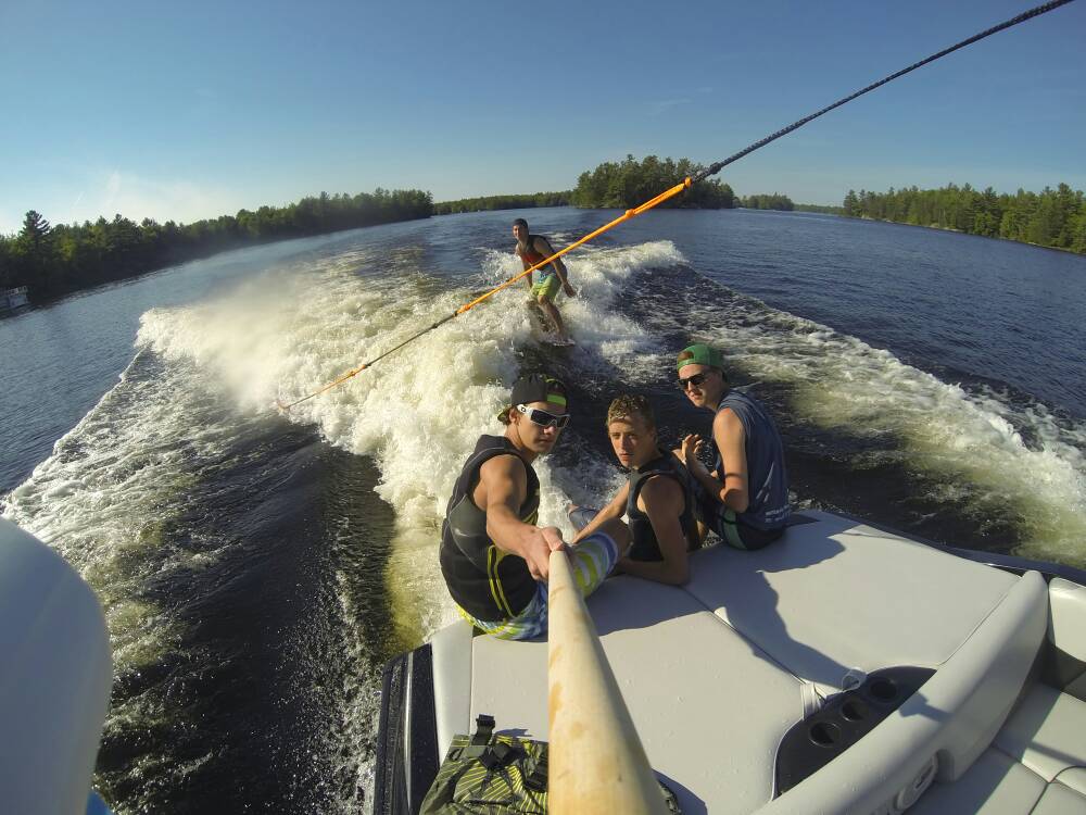

[attachment=-1]uploadfromtaptalk1402191887689.jpg[/attachment]
Did what u said and it worked out really well. This is the best that I could find in terms of 300lbs men
 Post subject: Re: Surf gate
PostPosted: Sat Jun 07, 2014 10:07 pm
No offense but that wave is pretty bad (washy) for surf gate. Keep playing with it, the A20 can have a very clean nice wave.
PostPosted: Sun Jun 08, 2014 7:34 am
What was your speed? Looks a little slow
