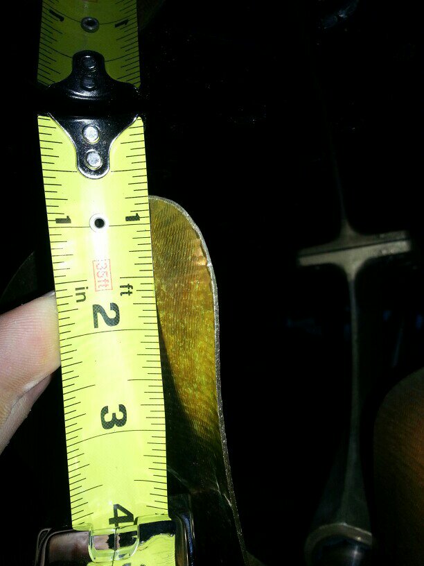

Here is the clearance on my 2315 on the A22.

Yes the clearance is good. He thinks the smaller diameter might work better with the smaller 330 motor
