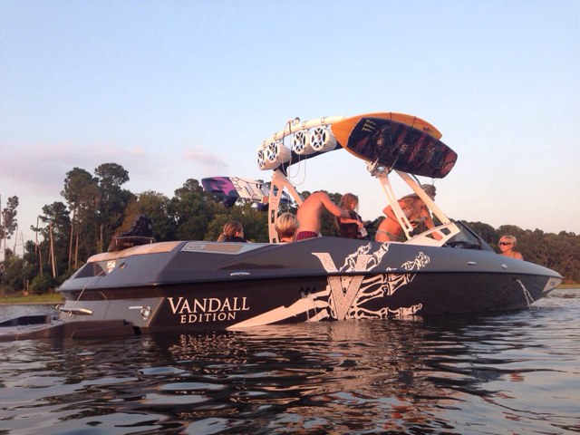

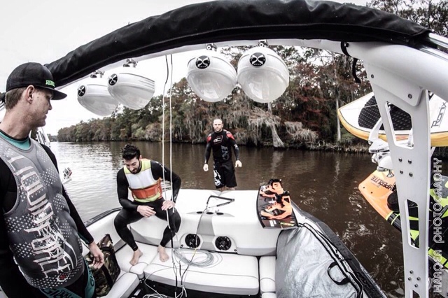

I love mine. Good choice

Texas boy the white is badass!! How'd u manage to pull that off?? I was planning on having the grilles and clamps painted but didn't know about the cans! That looks clean! Also do you have any idea about the 2010 tower and my wiring issue?
 Post subject: Re: 10' A22 Exile install
PostPosted: Tue Nov 26, 2013 6:48 pm
I think you can custom order them that way now. Check with whoever you purchased from.
As far as wiring goes jus use existing wires or string to pull new wire. Mine came pre wired and I just used old wire to pull the new.
