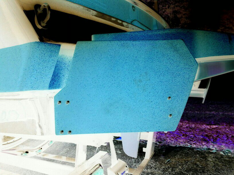

Negative

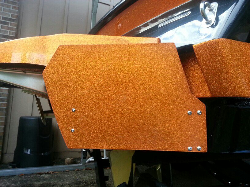

 Post subject: Re: Axis Surf Gate Measurements - 2014 Axis A22
PostPosted: Sun Oct 13, 2013 7:27 am
Starboard

Thanks! That will work just fine. Later today Ill; transfer the measurements, cleanup the image , and scale it to actual size to make a good template. Since most folks dont have a large format printer, Ill split is up across 4 pages and add alignment dots.
