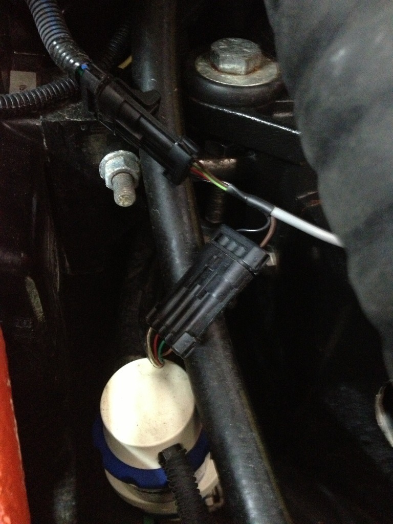

Check the connector for the transducer, right below the chillax seat on the port side, next to the thru-hull pump for the rear ballast, may have moisture in the connector causing problems. Here is a not so good pic I took when installing my GPS

Thanks for the image and suggestion Walter. I will take a look at this area tomorrow and report back on whether I'm able to get it fixed.

On the 2012, the paddle wheel only has a short cable, maybe 5 or 6 feet. It plugs into a harness on the port side of the engine. You may want to look there too.

We opened up the area back by the engine as you suggested Walter. We found the speedometer unit which is made by a company called Airmar. It's basically just a tube with a wire going into it that then goes through the hull and it has the wheel on the bottom side of it. There were two screws on the top that I took off and that allowed me to take the cap off of the top of it, but it didn't really show me anything additional. There isn't any kind of a connector. The wire just goes down inside the tube and then the other end goes in toward the engine compartment. There was a small amount of water in the top of the tube when I took the cap off of the top. We left everything open and wiped up any water that we found in hopes that it would dry out during the week. I don't have high hopes that it will resolve things, but maybe we'll luck out.
I haven't followed the wire from the Airmar tube into the engine compartment yet. I will try that Saturday and see if I can find any kind of a connection that may be loose. I'm starting to think though that the wheel/tube part may be going bad. The wheel itself spins freely, so I don't know what else would really be in there that would go bad, but it sure seems to be something with that piece.
