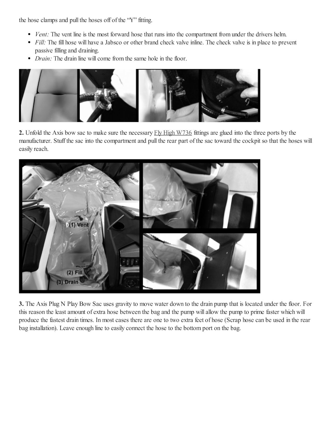

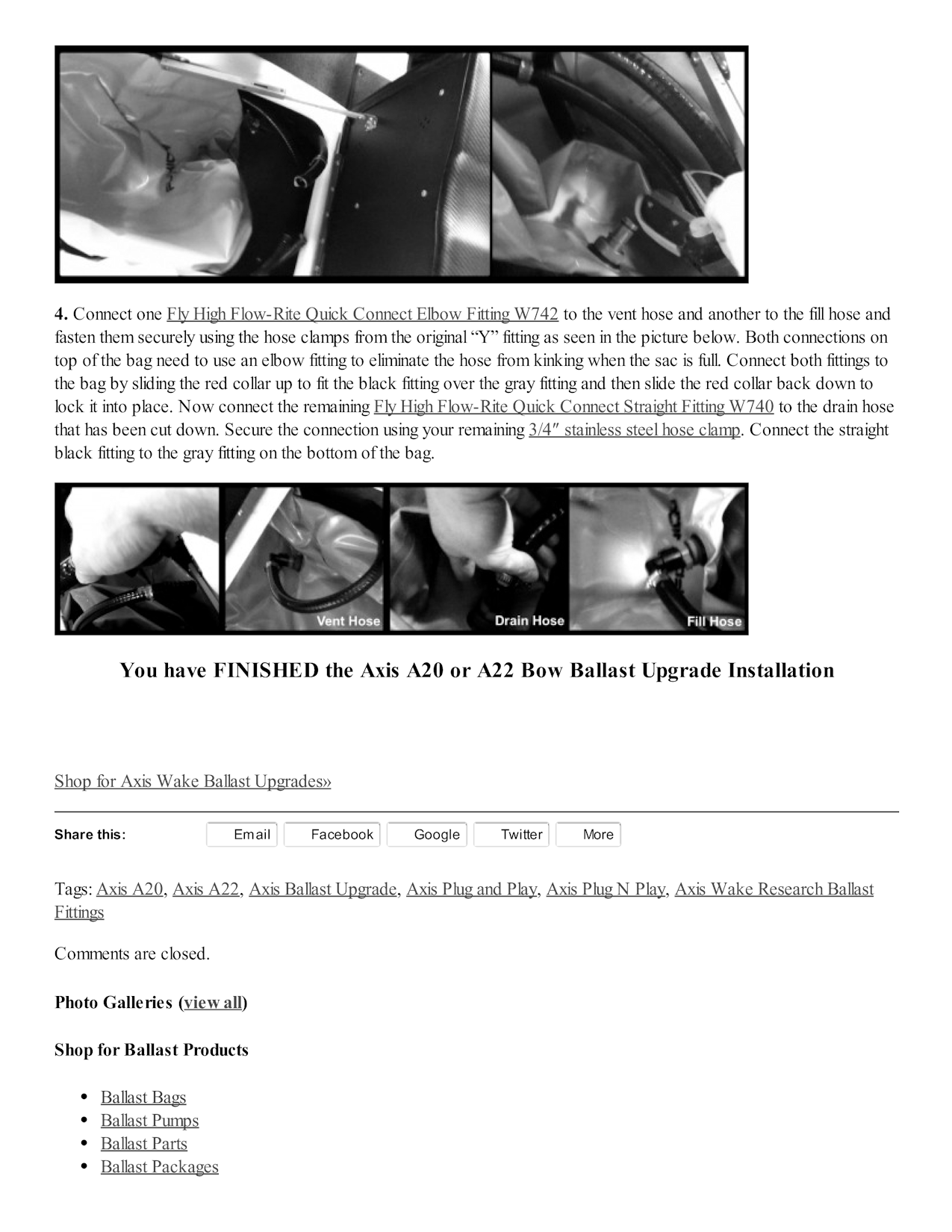

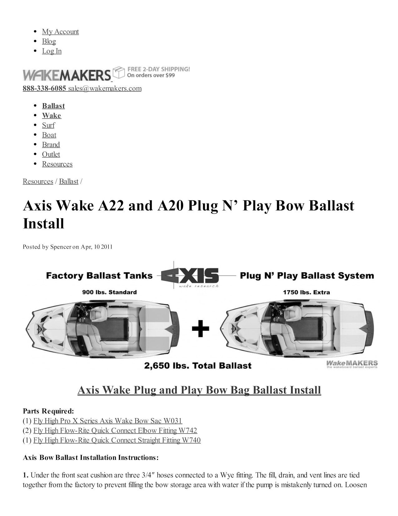

Have a read
Axis Wake A22 and A20 Plug N’ Play Bow Ballast Install _ Resources1.1.png [ 233.03 KiB | Viewed 20379 times ]
Axis Wake A22 and A20 Plug N’ Play Bow Ballast Install _ Resources 2.1.png [ 379.08 KiB | Viewed 20379 times ]
Axis Wake A22 and A20 Plug N’ Play Bow Ballast Install _ Resources 3.1.png [ 331.75 KiB | Viewed 20379 times ]

thanks but its not like on 2015 boats, no Y ???

Sorry, I thought they would be the same. I copied and pasted this from a post where they were installing a bow sack in a 15 A22
"On my A22 (same bow as A24), I had two drains lines on each side closest to helm and then the line that circled around needed to be disconnected from the barrell fitting at the passenger front side. If I remember correctly the hose going under the driver helm was the vent. I guess they connect the vent and fill in case someone flips the switch without a bag installed. Hope this helps."
Hope that helps.

The front bag:
Pull your seats out and lay the bag in the compartment. This one is easy enough to start at the rear drain hoses.
Just take your hose cutters and trim them up so you have a little bit of hose showing, and hose clamp your Strait Quick Loks to the hose. Tape over the hose clamp.
The two 90 degree connections will be going into the two ports near the nose of the bag/boat. Reach up under the seat towards the nose of the boat and find the hose line. Careful and watch for fiberglass splinters.. the suck.
This hose line has a barb fitting, cut the hose on either side of this seam. Hose clamp a 90 degree fiting to each hose and connect to the bag ports. The one on the Port side is your fill line and has a Check valve installed on the hose. The starboard side hose is the vent and goes to the thru hull fitting.
After that, head to the lake and enjoy your newly weighted boat.
Correct, its two hoses that meet together at the very front of the bow. There is a piece they are both attached to making it look like 1 hose. Separate them!! And follow directions in my comment above
